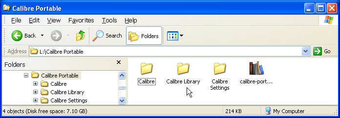

are you running Calibre Portable?
There is a required folder structure (and it requires full rights for the entire path).
It must start there.
Since you only found 1 metadata.db there is only one there

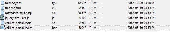

@theducks : That line above metadata had me wondering too - but I also have that file in Program Files (X86)/Calbre2/resources - along with others with the same Mod date, and I see the same files in my Calibre Portable program folder
Hidden extensions: dot Bat.
I don't allow that. Never have
I was expecting the results for a filename search of 'Metadata.db', not a word search .
When I do the search in XP, I only find 3 of the specified file (the ones on connected drives: testlib,working_lib and a backup copy)
And I have always done the opposite - since Burroughs MCP at least - that's why I don't use Windows Obscurer as a file manager.
The OP did exactly as you asked him/her to do "Use the OS to search for 'metadata.db.
That batch file is riddled with string "metadata.db" eg :-
IF EXIST %cd%\CalibreMetadata\metadata.db (
	IF NOT "%CALIBRE_LIBRARY_DIRECTORY%" == "%cd%\CalibreMetadata" (
		SET CALIBRE_OVERRIDE_DATABASE_PATH=%cd%\CalibreMetadata\metadata.db
		ECHO DATABASE:           %cd%\CalibreMetadata\metadata.db
		ECHO '
		ECHO ***CAUTION*** Library Switching will be disabled
		ECHO '
