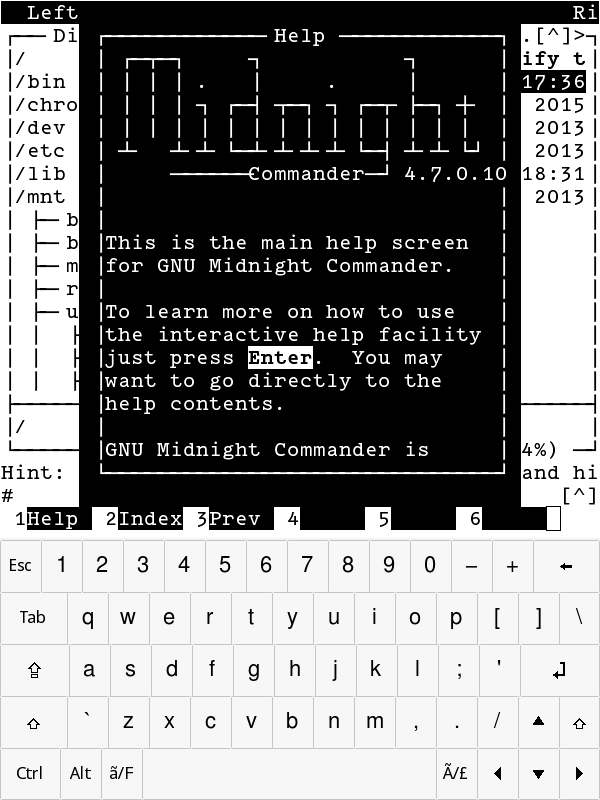

I installed midnight commander on my kt3 and was mucking around with it, when I came across this thread.
I can't remember the link in MR from where I downloaded the dump. It creates a folder 'local' in /mnt/us with 3 sub-folders: mc, terminal and lib. The total size is around 10 MB.
A KUAL button doesn't seem to be available. My attempts to create it failed. So I managed with a script in the /mnt/us/kterm folder: mc - which contains:
export LD_LIBRARY_PATH=/mnt/us/local/lib
/mnt/us/local/mc/bin/mc
The question asked here: how to create mcedit - remained incompletely answered. I created one more script: mcedit - containing:
/mnt/us/local/mc/bin/mc -e $@
To round off things, I also created mcview with:
/mnt/us/local/mc/bin/mc -v $@
The 3 flavours of mc can be started from kterm as: ./mc, ./mcedit and ./mcview
The KUAL button remains to be created - experts help needed!
Also, the /mnt/us/local folder seems to contain many unused files - need to identify and remove.
Quite nice to see the mc 2-pane view on the Kindle! See screenshot attached.
