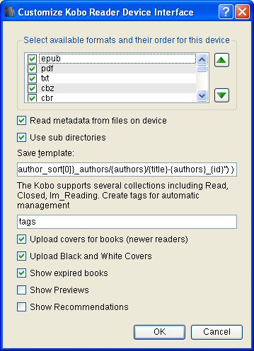

Time to look at the device driver plugin.
Preferences: Plugins: hunt for) Device Interface... : Kobo...

Fixed!!!! Bless you little bones Ducky.
I went to the plugins folder as you suggested and found the Kobo reader plugin greyed out - the only one in the whole devices list that was greyed out. I enabled it, restarted Calibre with my Kobo plugged in and the Send to Device and Eject Device options are back.
I did not disable this plugin option. Never been near the device plugins before in my life. Actually surprised at how many there were. Something disabled it though and the only thing I can think of is that the neighbour's Kindle did so when I plugged it in.
