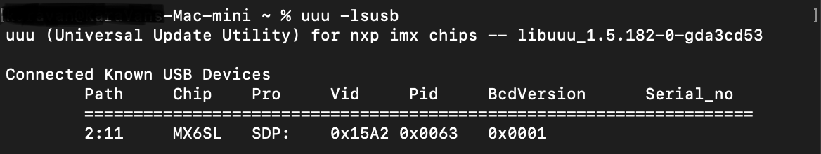

Name:	Screenshot 2025-03-15 at 1.03.24 PM.png
I have a kindle dp75sdi (which looks like it was paperwhite), and I am trying to recover it. It is shown as this when connected via USB (cannot access filesystem via UX)
SE Blank MEGREZ:
Product ID: 0x0063
Vendor ID: 0x15a2 (Freescale Semiconductor, Inc.)
on the mac terminal.
I downloaded the UUU took and the tool is able to recognize it. I am now wondering where can I find the uboot.imx file
I am ok with flashing any OS/Mod. I just dont want this hardware to goto waste.
This is where my knowledge ends. Please help a old man out.

You can try to refer to this post to use TLL to connect KPW3 to flash the kernel and system https://blog.csdn.net/feifeibest168/...ails/129777634
You can use GOOGLE translation to read
One thing to note here is that it is best to install the driver dedicated to the kindle CPU instead of the general Android ADB driver, otherwise the flash command cannot be run in the CMD window

Or you can try to fix the problem by short-circuiting the circuit. The tool you use is MfgTool.
