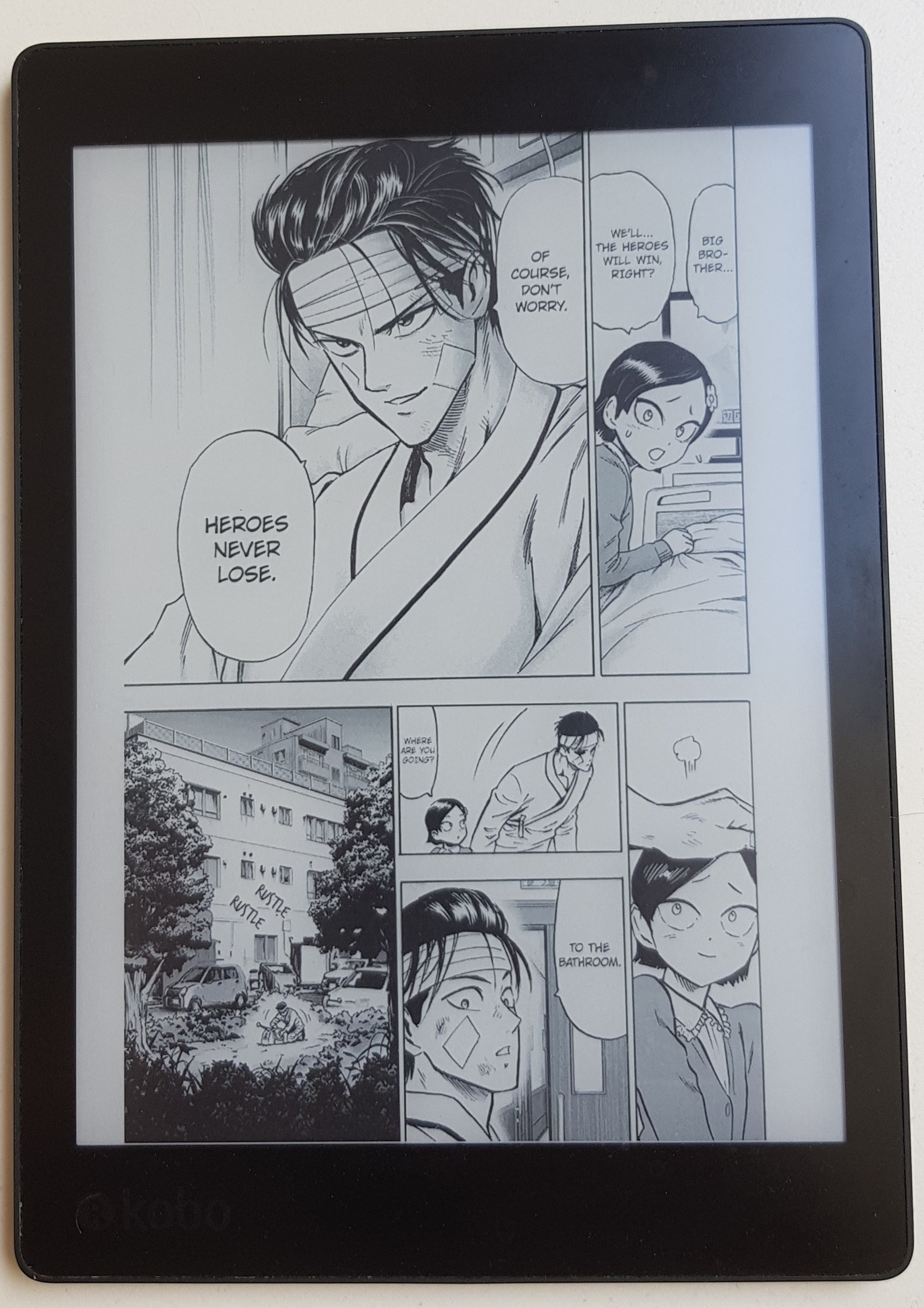

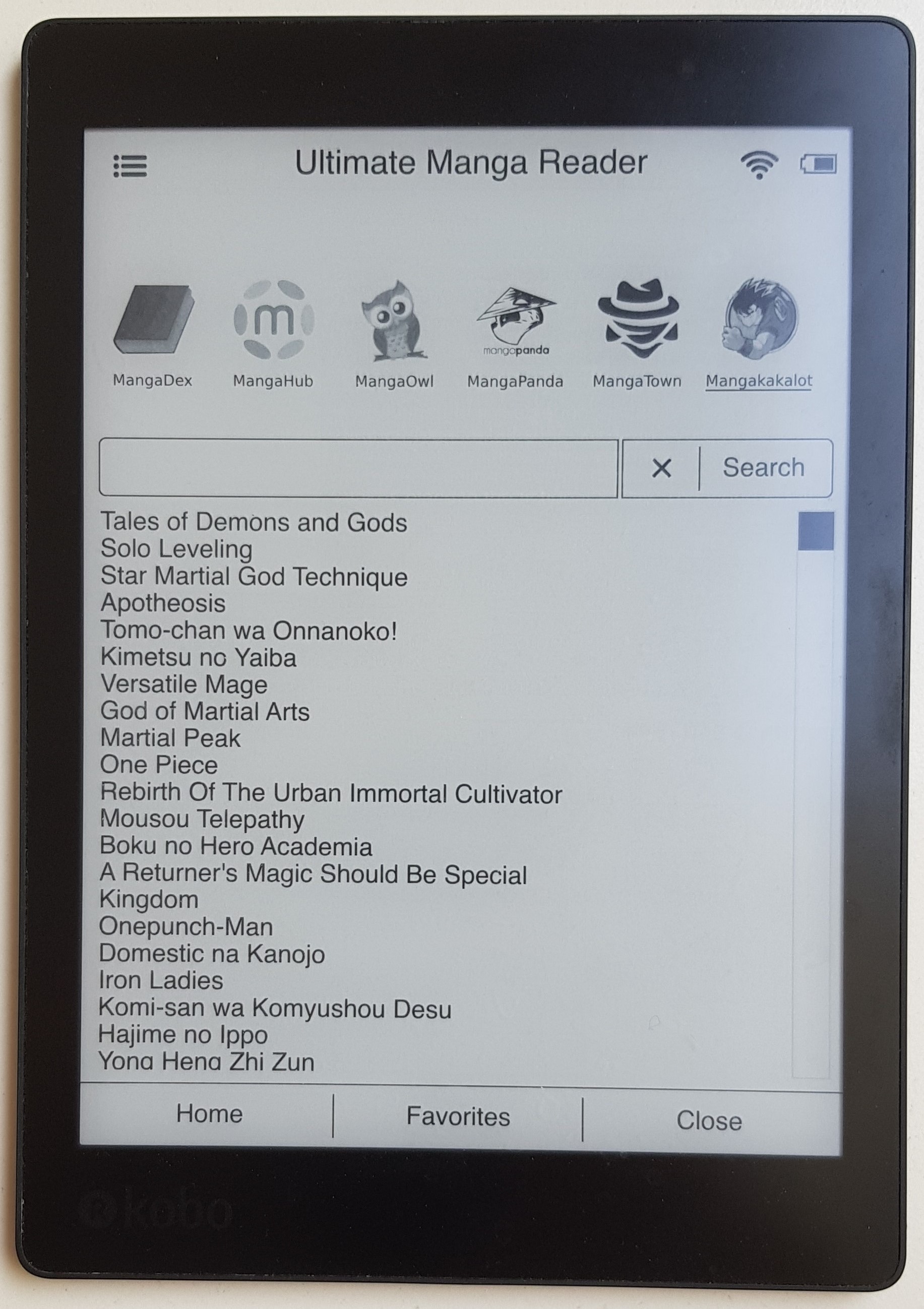

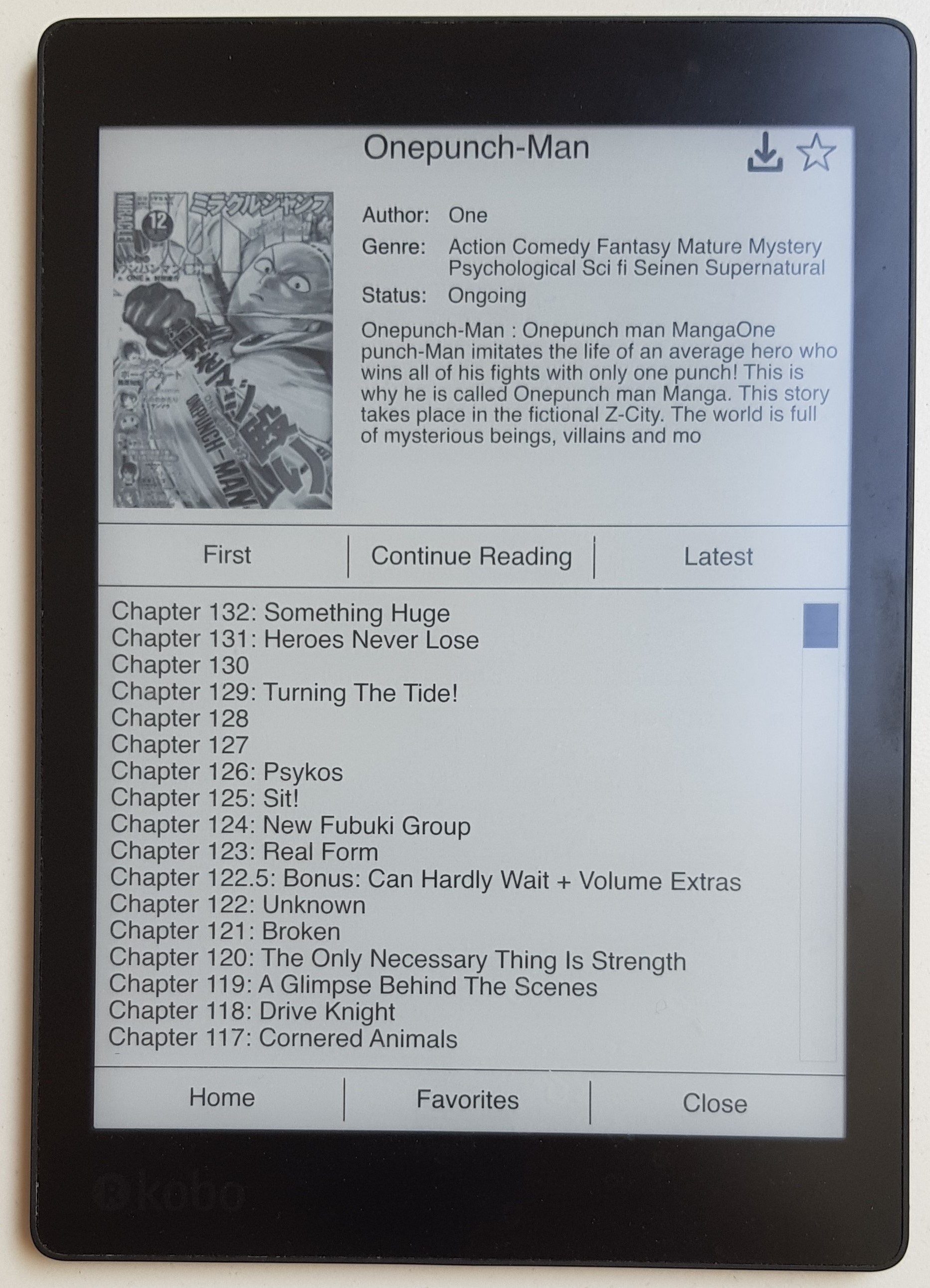

Post All new Ultimate Manga Reader
A feature-rich online manga reader for Kobo E-Ink devices.
Compared to the one I posted a few years ago it's basically a complete rewrite.
It's now based on the latest Qt5, it's standalone and has tons of new features, bugfixes and design improvements.
Features:
  • It comes with a refined, modern design and a GUI that is DPI independent and will look great on various platforms.
  • It supports multiple websites as manga sources with tens of thousands of available mangas.
    Currently supported websites are: MangaDex, MangaHub, MangaPanda, MangaTown and Mangakakalot/Manganelo.
  • It's fast. It will stream, prerender and cache mangapages in advance while reading to minimize loading times and to enable the perfect reading experience.
  • It supports offline-reading. Mangas can be downloaded in advance and read later without internet connection.
  • It supports favorites and bookmarks reading progress automatically, so you can pick right up reading where you left off.
  • It is designed to be ergonomic on E-Readers. It supports configurable gesture inputs, frontlight control and a sleep mode. Custom screensavers can be placed in the screensaver folder and will be picked at random.
You can find the source code and additional info here.
