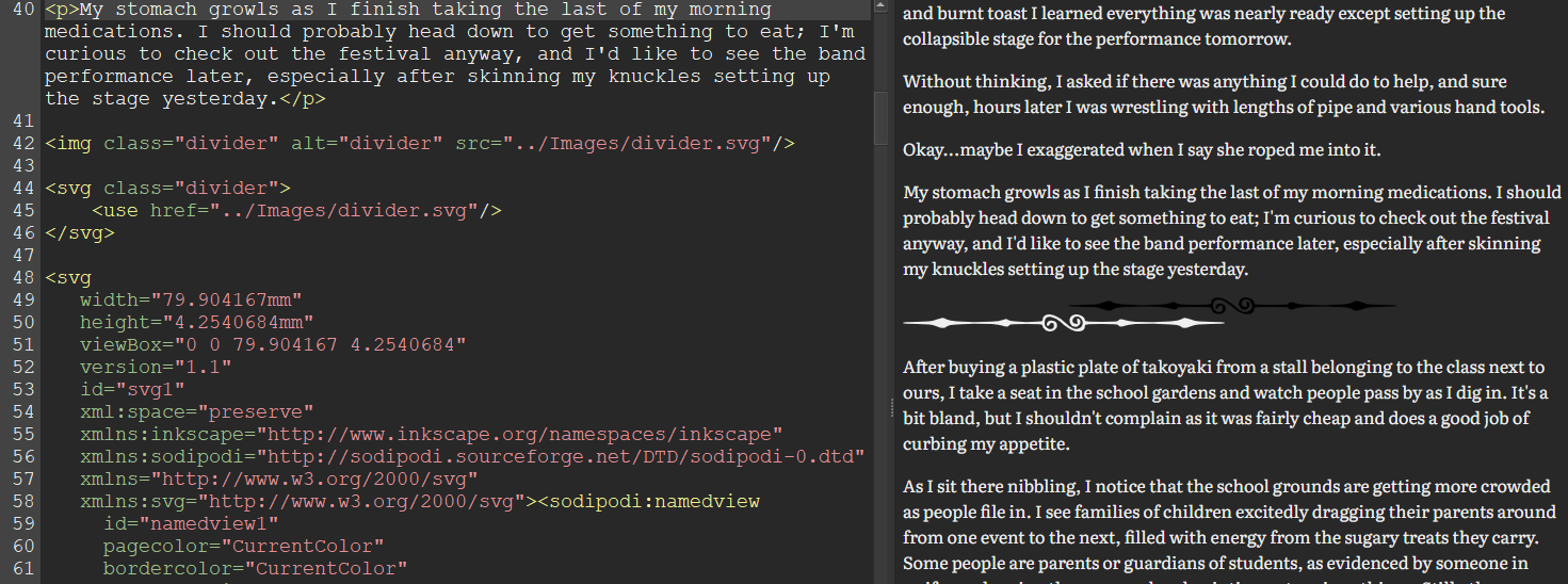

Hello everyone,
Probably a noob question. Sorry about that.
I am trying to create an epub from texts found on the internet, and some chapters feature a divider, which I reproduced as an svg.
On Sigil, I can import it and use it as an image but here's the catch : I want to make it the same colour as the text (so that someone who would want to read with a different colour scheme can have a more consistent experience).
I am aware I can use "fill:currentColor", but I can't get things to work how I want them to :
  • Either I import the svg as an image, and then the fill doesn't cascade to the svg, and the image stays in black ;
  • Either I copy-paste the full svg code in the html file, and things work but my code becomes a nightmare (and it is probably inefficent) ;
  • Either I try to use (probably very badly) an href in my <use> with a , but then nothing happens.
Here's the coding situation :
This is quite infuriating and I'm out of ideas...
Hence my question : do you know a way to import an svg that will keep the current Color attribute ?
I feel like the <use> stuff could help but I must misundertand how the element works...
Anyway, thanks in advance, and have a wonderful day !
EDIT : Huh. The imgur link doesn't display the image... Here's the link
https://imgur.com/a/im-so-very-bad-epubing-ilVXkOG

Go Advanced and attach an image.
Duly noted ! Thanks a lot !
So here's the picture of my being bad at epubing...
You can see three attempts at displaying the svg divider :
  • the first one that displays the svg but with wrong color;
  • the second one that does not display anything;
  • the third one that displays what I want (modulo some sizing tweaks but I can manage) but makes the code pretty unapproachable

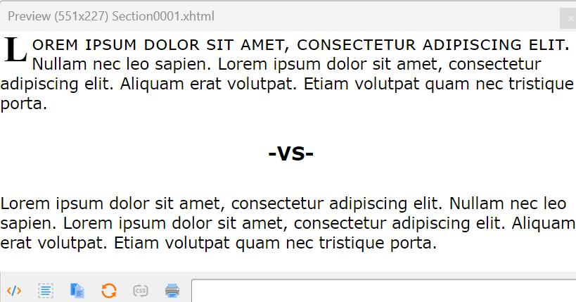

The only way to do pseudo coding is to use spans for the fallback So no need to bother with the pseudo coding in the first place.
Not at all true.
The pseudo-elements he was referring to were something like hr.ChDiv::after or h3::before.... IIRC these took a little longer to get widely adopted, but ::first-line and ::first-letter have been around forever. If kobo doesn't support them then kobo DRASTICALLY needs to update their software.
A Kobo using RMSDK will not work with pseudo coding. So there you go. That's a very good reason not to use code that's not compatible but can use other code that is compatible.
If the devices in your target market refuse to transition into the 21st century then the fallback coding could be as simple as not displaying the first line in small-caps and instead showing a normal sentence....
for example:
The first paragraph supports pseudo elements.
The second paragraph doesn't and simply falls back to the older styling.
Name:	Screenshot 2025-03-06 203726.png
No spans were used in the making of this image...just a simple class (<p class="first">) and pseudo selectors. The paragraphs are otherwise identical.
It's certainly not as pretty, but it is definitely readable. If the user doesn't like the basic look enough, then they can use a different/newer reader.
IF the publisher INSISTS on a "one ePub to rule them all" then this is perfectly acceptable. IF, however, the professional publisher has a different css file for different markets/devices then Bob's your uncle (I miss Hitch!).
You definitely are not required to limit yourself to ePub2 ONLY coding just to accomodate the outdated devices...there are many other options!
