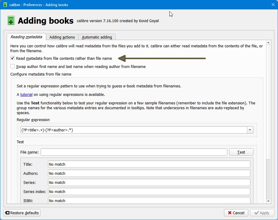

That says the two installations have different preferences settings. Probably the "Read metadata from file contents rather than file name" is checked on the one that works and is not checked on the one that doesn't work.

1. As I said, I have tested it on 2 PCs: my new one (where the first page of the PDF does not appear as the cover but rather the one Calibre generates based on the metadata) and another PC, where Calibre was already installed and the first page does appear as the cover in the PDF files.
Both PCs have Calibre version 7.16 installed and both are running Windows 11.
2. I have checked the 3 existing tabs in the Preferences - Add Books option (Read Metadata - Adding Actions - Automatic Adding) and both PCs are the same. Specifically, the option 'Read metadata from file contents rather than file name' that you mentioned is checked.
joten is offline   Reply With Quote

On my system, Win 11 with the calibre preview edition (7.16.100), if I check that box an added PDF will show the first page as a cover. If I uncheck that box then an added PDF will not show the first page as a cover.
The setting has no effect on PDFs already added. They must be either a) deleted then re-added, or b) have the cover changed manually.
I have no explanation for why it works for me and the other two posters but doesn't work for you.
