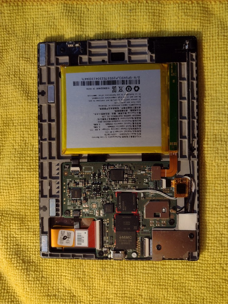

The magnets are nearer the back so the attraction there is strong. I removed 7 magnets from the left side and top and two from the right side. You could actually still use the cover as normal that way, although the cover would be a bit lose on the left side when the cover was open. Still, you can see that there is a ton of magnetic overkill here.
I cut the back cover down to 1/2" of the "chunky" bit. That material is tough, I have no idea what it is. It took a dozen cuts with a carpet knife on both sides to get through. At least it cut fairly cleanly. The leatherette is well bonded, so no fraying edges.
The front flap still stays put when you hold it face down and the auto sleep still works.
I'll be installing a T-nut where the "X" is, but imagine my dismay as I realized that I didn't have any right in stock.

Wow, they went overboard on those magnets. I just took out another 4, that makes 13.
I figured that the cover was uniformaly magnetized, like those business card magnets.
Not so! The front and rear cover have embedded super strong magnets at certain points.
The right side of the case has about 10 magnets, but only 4 interact with the front cover.
So, for all the people who are replicating this (i.e. none) you can take it down to these four magnets.

I took apart the piece of the back cover that I wasn't using.
The backbone is 1.25 mm (0.050") acrylic.
The magnet are the same thickness, that is, thinner than the ones in the case.
Mmm, I think that I'll try to split the 1/2" remnant of the back cover and remove the acrylic and the still more magnets that are there.
Edit: So I did remove that bit of backbone and magnets on the back 1/2".
It came out pretty well, I didn't even have to split the side seams.
Of course, it would have been easier to do before it was attached to the back case.
In any case, look at all the magnets that I got rid of!
So now the front flap has four magnets for the right side closure and one magnet for the Hall effect sensor. So there is no useful modification to the front flap.
Inside there are the four remaining magnets as shown in the previous post.
