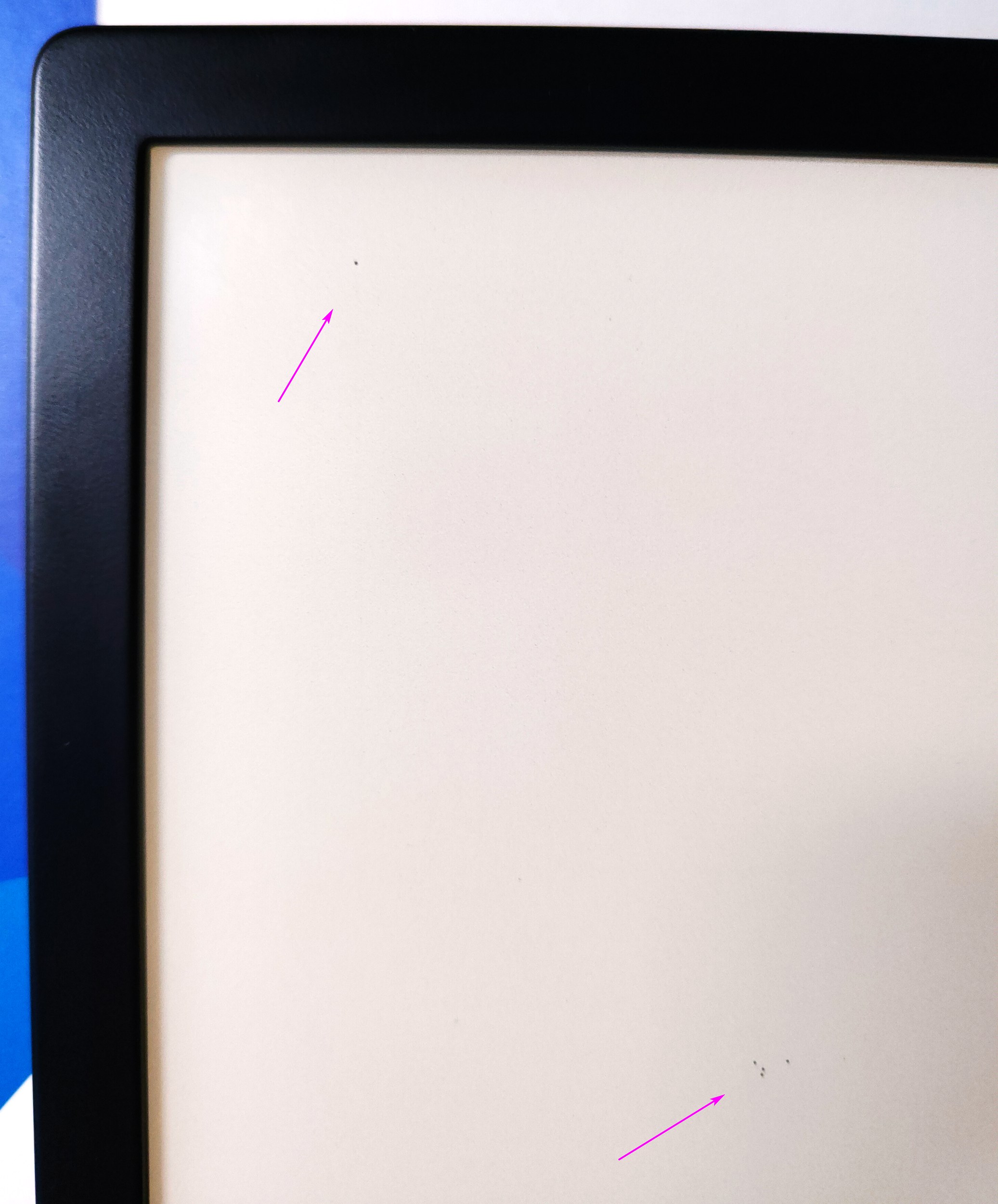

Got a new Libra 2, and straight out of the box it started to touch itself – sensor is registering touches without my input. Text is being selected, books are closed, etc.
I wiped the screen with alcohol and reflashed the latest firmware version (which was already installed and clearly isn't the issue here). It didn't solve anything, but later that night I read for an hour without any problems. The next morning the touches returned. They are easy to spot in Sketchpad (attached photo). The most obnoxious is top left spot, which is being triggered 10 to 100 times per minute. There's also a cluster of 4-7 spots in the center.

What should I do about these touches?

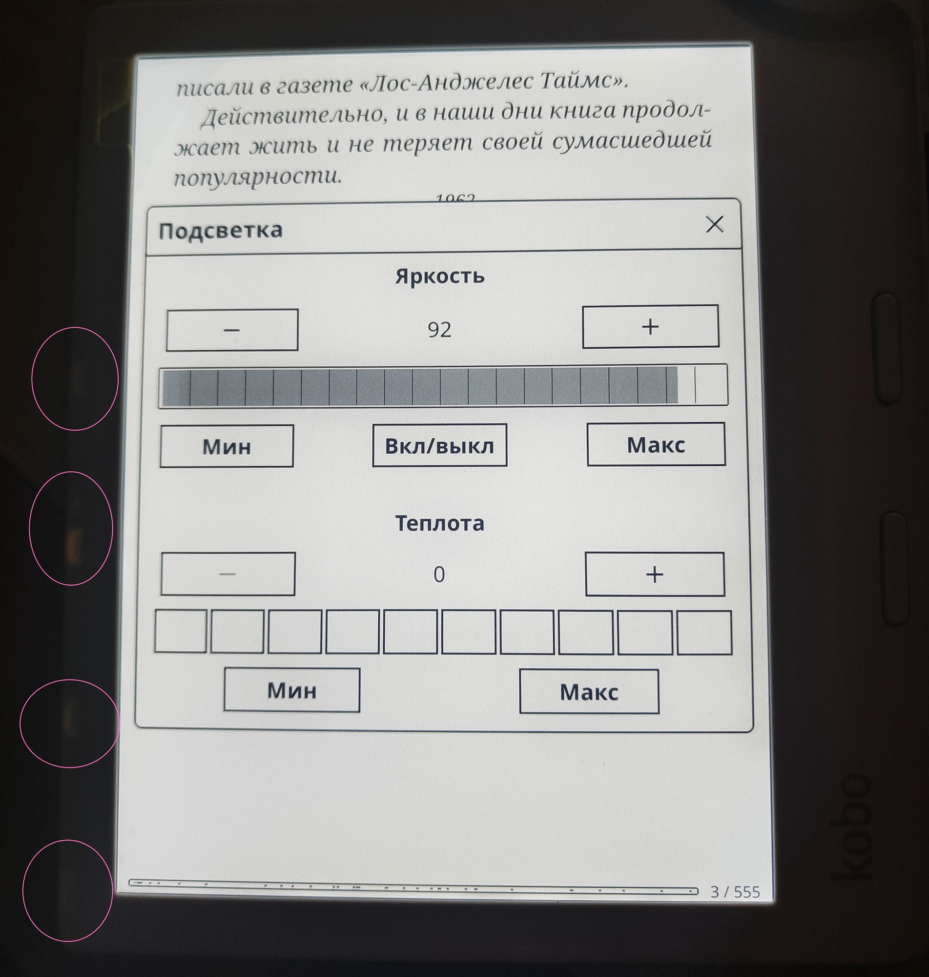

The tragic thing is that this is the 4th Libra 2 I've bought and 3rd to have issues/defects. Previous two had spots on the left side where backlight was shining through (attached photo). And one was seemingly fine.
Is this the quality one can expect from Kobo? I wouldn't really care had I lived in US with the access to easy returns, but it's a bit more expensive where I'm from.

Try a microfiber cloth to wipe the screen. If that doesn't work, try a manual firmware update.
Microfiber didn't help. There's nothing on the screen. Perhaps some dust got under the bezels?
4.35.20400 was what I had installed initially (or after autoupdates). Then I manually reflashed it like you said, thinking it fix the touch bug. Reflashed it again now, nothing changed. Top left corner is keeps being "touched".

I've tried various FW versions coupled with factory resets, nothing helps.
The touchscreen can work fine for an hour, but leave the device to rest for some time and the issue comes back immediately after waking up.

What could maybe be done, is a software hack that disables the touch screen entirely while you read a book using the pageflip buttons exclusively. Or, if the touches happen in very specific coordinates only, a hack that filters touch inputs for these specific coordinates.
But in terms of hardware, you need a replacement. I doubt this can be fixed by opening the device, the front is not reachable anyway unless you disconnect all cables, all of which are glued/waterproofed/messy. And even then the frontlight, touch layer, display are more or less laminated into one unit.
The see-through issue wouldn't bother me, since I don't read in the dark and my brightness setting is quite low. That said when you open the device there is some black tape that is probably specifically meant to deal with this issue. But I don't know if opening could help with this at all...
