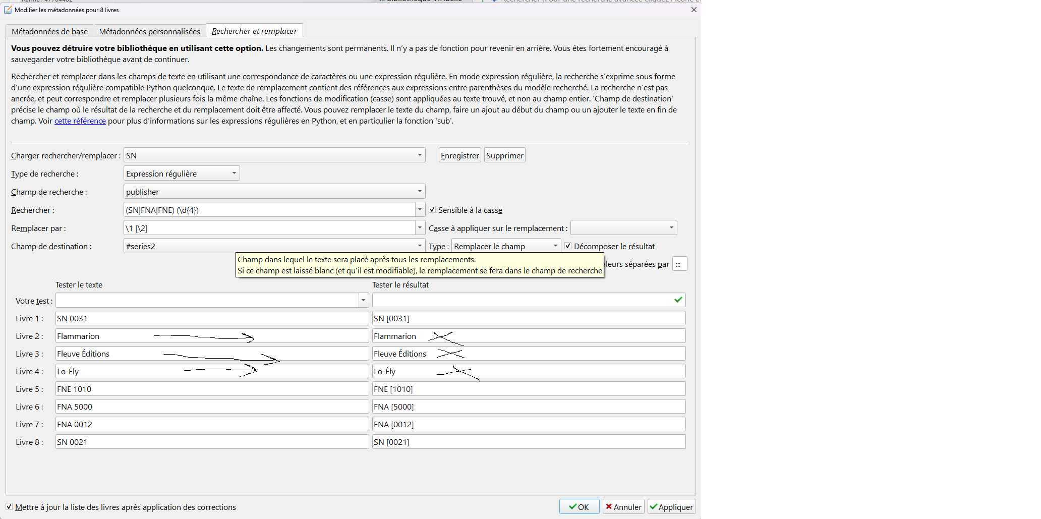

Just one more question .
As you can see on the image file , the filter is correctly applicated but it takes also others formats in the destination ?
How to applied ONLY SN (\d{4})
search&replace take action on rows where the filter it's not applicated ... strange . the "do_nothing" in my if/then/else doesn't work
Thanks for your help
Exemple : if publisher is "Flammarion" you will have in Series2 Flammarion!!! It should be empty

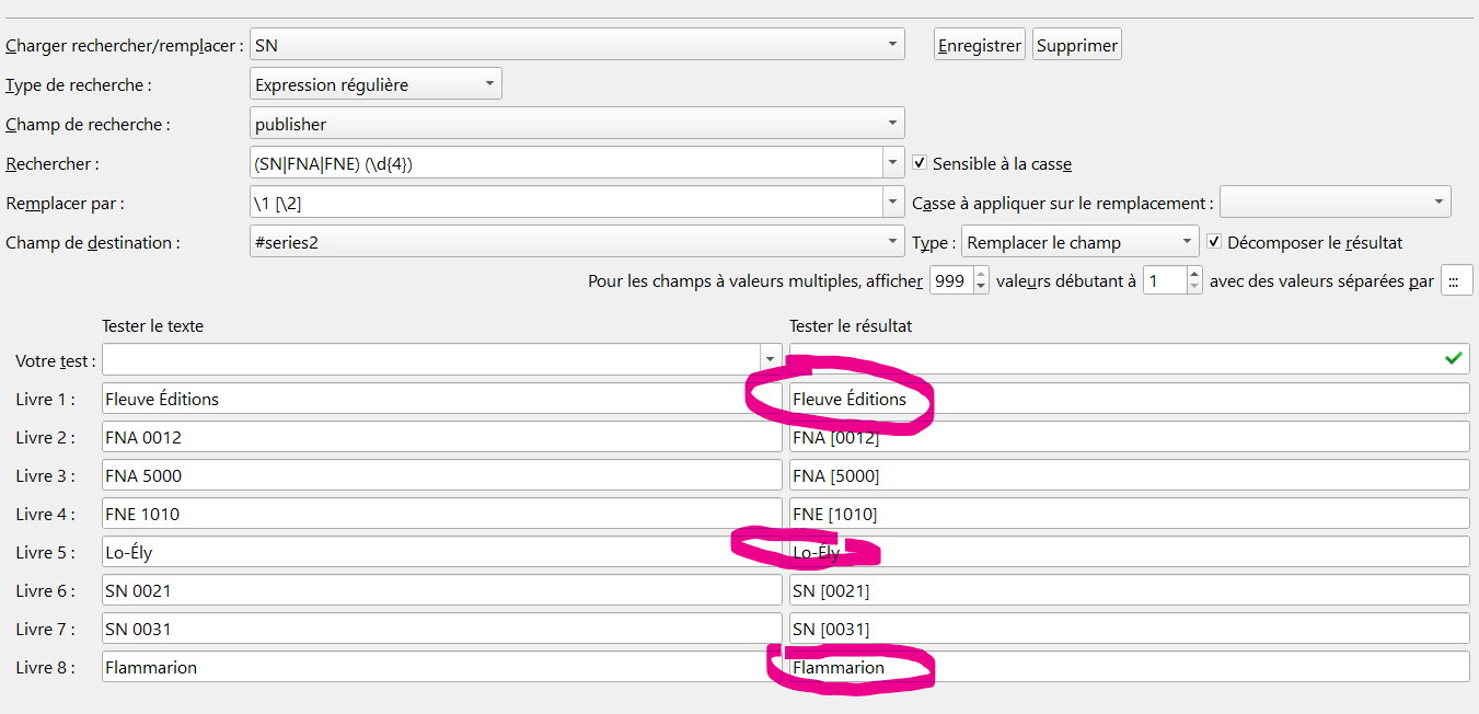

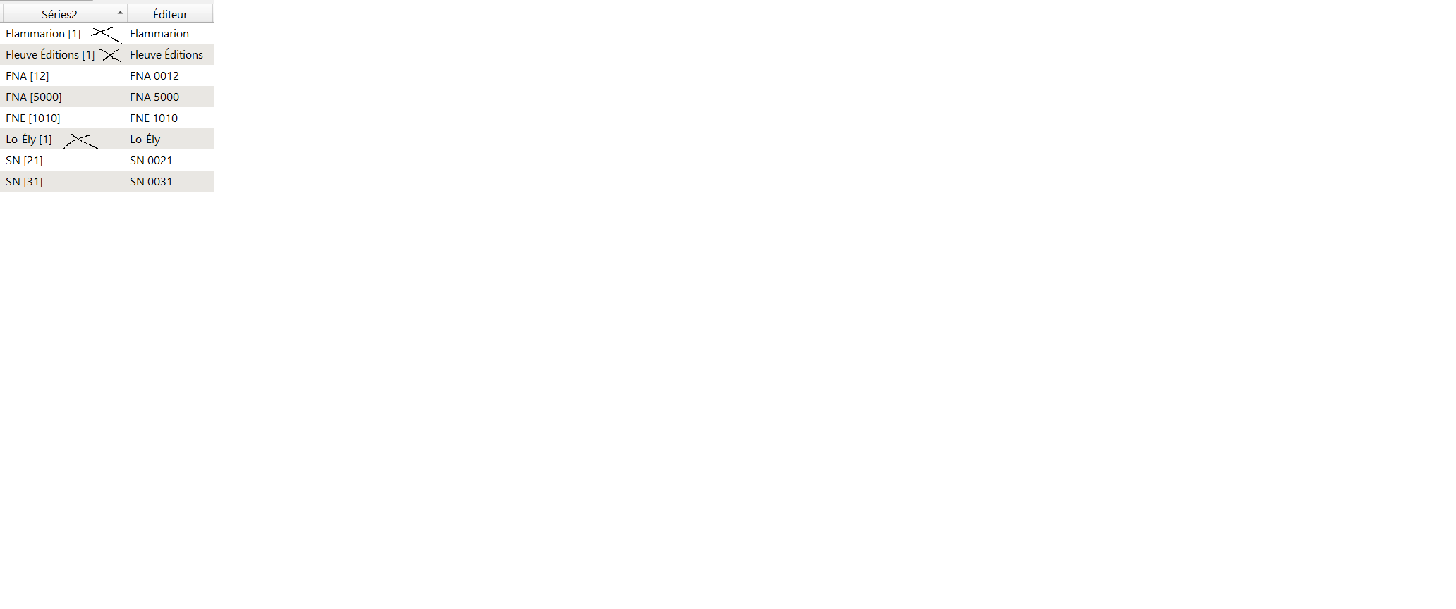

Yes it does the job on all selected rows but it's also copy all not selected rows in my columns #series2 form publishers as you can see on the image SN3.png
The filter it's not exclusive
And after i aplied, the result it's on SN4.png with wrongs results
So if it's should works as you said, i made a mistake .
Perhaps on the result field, a special syntaxe ?!?

Old 02-06-2023, 03:14 PM   #9
Posts: 31,326
Karma: 62025226
You did not First use The Library Search to only select books that start with:
publisher:~SN (\d{4})
Then use Bulk mode to do the move
