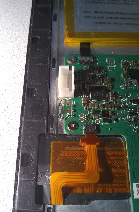

Me? I put a magnetic reed switch inside my Poke3 so that I don't have to ever open it.

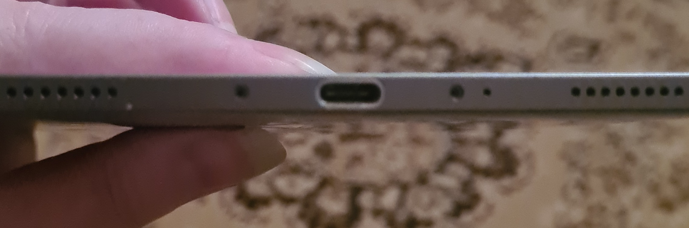

So, I've taken the two mini-screws out at the bottom of the Leaf. That's the only sign of anything other than the little hole next to one of the screws which is probably the mic anyway. Any tips for opening it because I don't know where to pry or if I'm going to break it. The Leaf is very sleek it's very hard to pry or get any movement there, I'm supposed to pull the case off from the screen? Another thing that is going to get in the way possibly is the pins on the left side of the device which are used to snap into the case.
ID:	192865   Click image for larger version

Yeah, I can't really tell how that comes apart. Some devices you just run your fingernail around and others you need a hammer (not really). The Nook Glow2 is put together with special double stick tape and you'd better have a supply if you want it to go back as it was. Is the back shell on the Leaf seamless and the only crack is on the front *inside* the outer shell? I've not seen one with screws like that. Any chance now that the screws are gone that holding it face-down and giving it a gentle whack that that bottom edge drops out of the shell? I think that it's more likely that this is stuck together with tape and the two screws are just to keep the Type C connector more secure, since you'd actually need clearance to pull that bottom edge out.
On the Glow I worked around the edges with a single edge razor blade. When I was through I cleaned up the old tape and used some new double stick (special) Tesa. I'd hate to see you mess up your new device.
