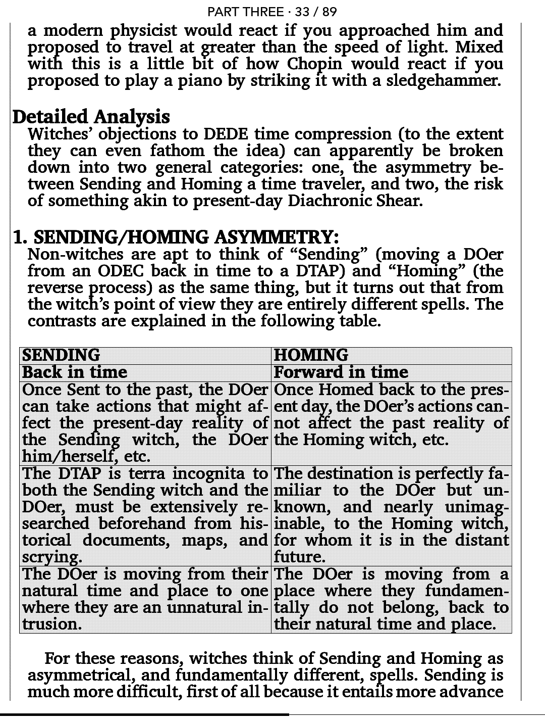

I've downloaded a fresh copy of this eBook. I've had a look at it using ADE 2.0.1 and the table displays perfectly well. I've also loaded it as ePub to my H2O (latest 4.24 firmware) and the section with the table is displaying no problem. I've made no changes and this is as the ePub came.
I suggest downloading it again and hoping you get the latest version which is 1.4mb in size (according to Calibre). The formatting is better then it was when I got it.
Attached is a screenshot of the page with the table using RMSDK (ePub). The font being used is ChareInk. Also works with Georgia.
P.S.I think I have the wrong page. But the formatting is a lot different from the original version to the current version. All the embedded fonts are gone and it does read better due to the change in formatting. I did check Part Four and it seems to display the text correctly using ADE 2.0.1 and RMSDK (Kobo).
