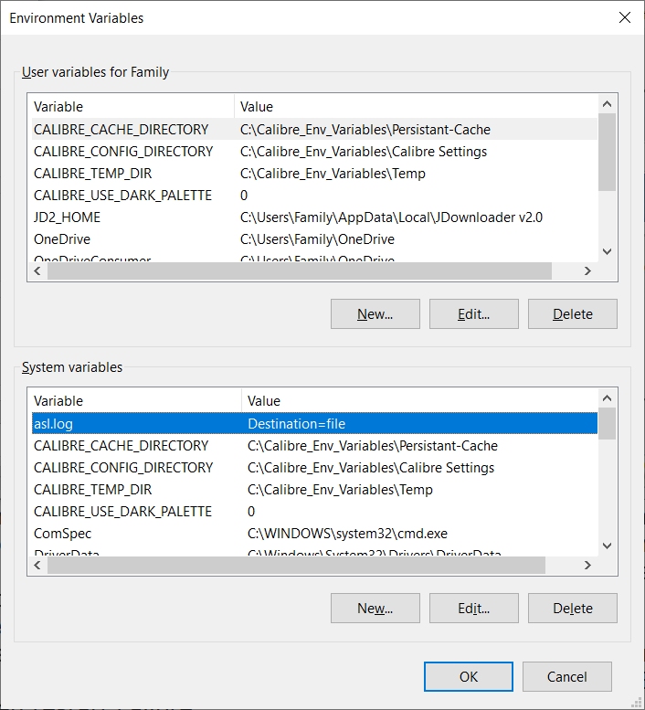

Originally Posted by iBookMan View Post
I also had to go back to 4.5 because I couldn't figure out a way to turn off "dark" theme. I like it for windows 10, but don't want to read white on black. There should be an option to disable dark theme even if opsys is set to it.
Kovid provided the following to turn off dark mode in calibre:
The link in the manual Kovid pointed to does a good job of explaining how to set the variables. I attached my variables as a general example. The system variables don't have to be duplicated in the user section and vice-a-versa.
Name:	Environment Variables.jpg
ID:	175656   Click image for larger version
Name:	New Variable.jpg
