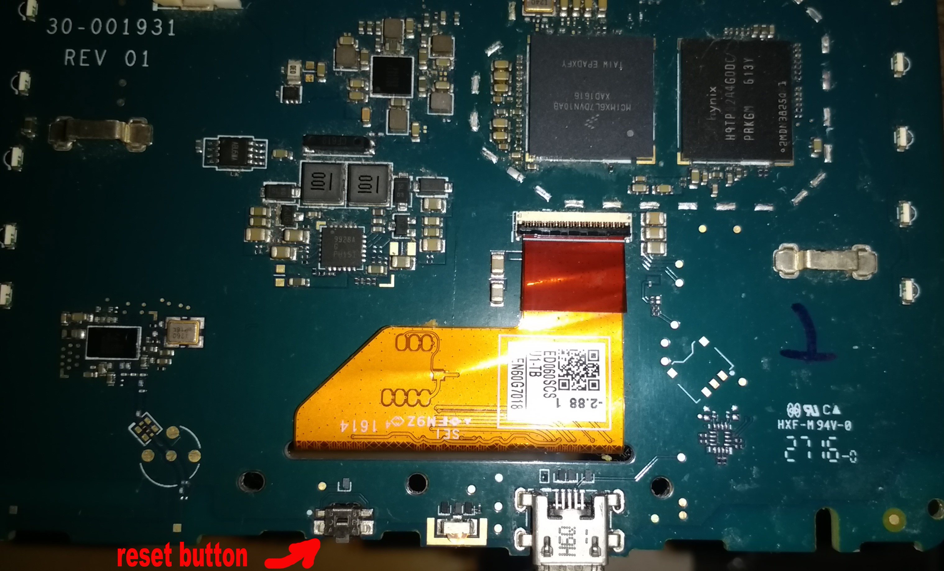

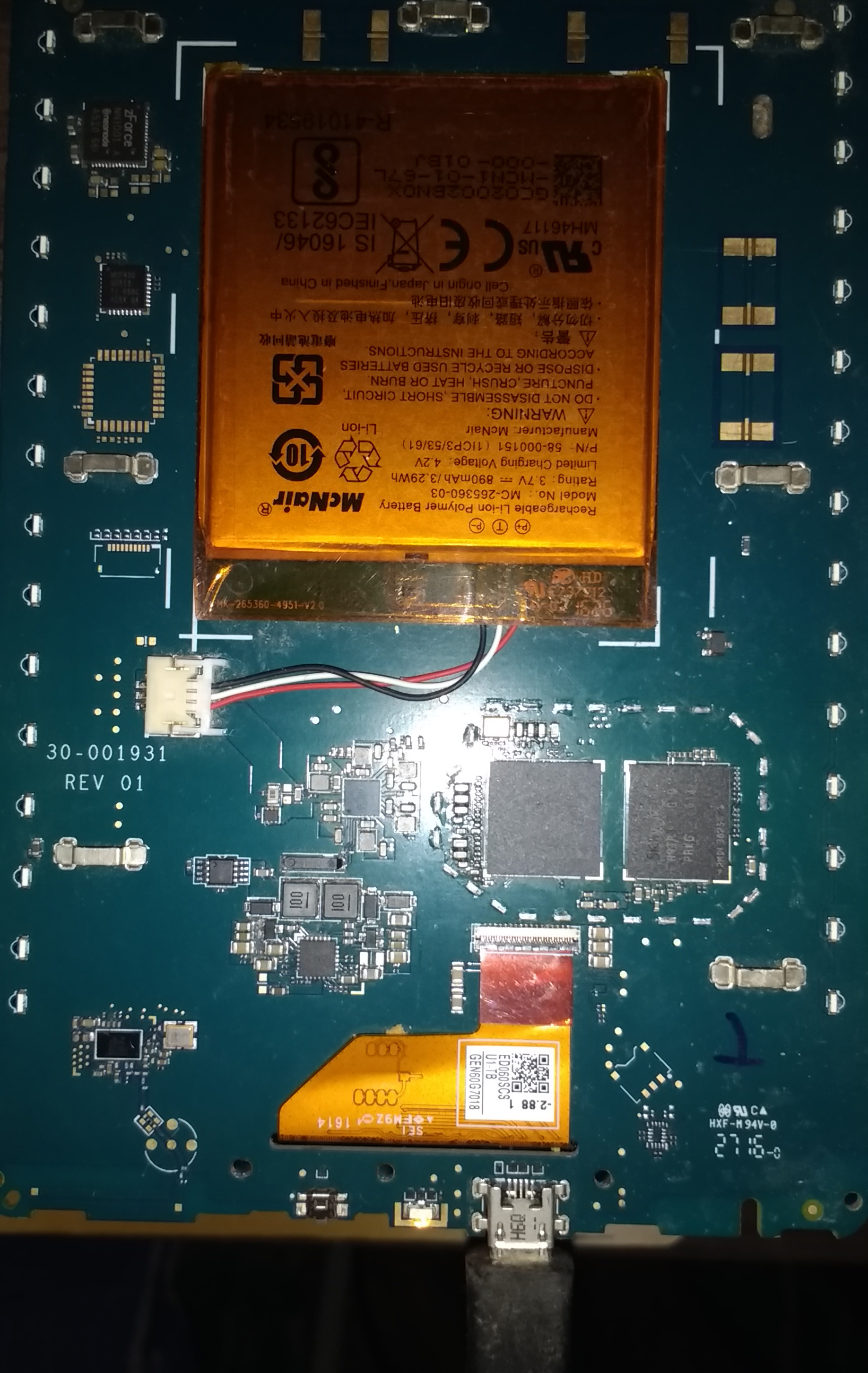

A couple of months ago I left my kindle connected to the USB of my PC and I forgot about it. The next day I grabbed the kindle and it was frozen, that is, I remain on a page of a book I was reading and there was never a way to defrost it.
Try all this:
-Press the button for more than 40 seconds to reset.
-Charge the battery until the light turns green and try the same and different steps of resetting youtube and the kindle page.
-I saw a video of how to disassemble a kindle, opened it inside and took out the battery and the connection of the flex and replaced them correctly.
-Everything remains the same, it is more 2 weeks ago the kindle has no battery and remains on the same page where I am frozen.
The only solution I can think of is to touch the motherboard of the kindle with a tin soldering iron, for that I think I need someone to help me. Someone should know how to do a reset of the kindle through the motherboard.
Is that or throwing away something that doesn't work for me more than a month ago. (I don't have money to buy another one)
Model motherboard "30-001931"

When I left the kindle charging his battery yesterday, the color of the light was orange, 2 hours, 30 minutes passed and the light changed to green (charged battery) and I left him charging the battery until the hours we agreed (20-21 hours) .
Disconnect the cable and press the button for more than 40 seconds. While the button is pressed the light turns on in green for 2 seconds, then flashes 2 times in the same color (green) and then automatically changes to orange, flashing in that color 5 times. And that whole pattern is repeated 4 more times during those 45 seconds.
I just tried to press and hold for 30 seconds with the cable on and something similar happens with no cable connected, with the difference that when I release the power button the light turns green.
*I have a kindle touch 8th the motherboard model is "30-001931"
The last photo I uploaded is not from my kindle, it is from another kindle old of some unknown user of another forum that the only way to solve the freezing of his screen was by touching the motherboard. My Kindle is the one above where you can see two photos together.

The picture you added is from a different and much older Kindle model. It looks like a Kindle keyboard model reader. AFAIK there is no reset switch like that for your KT3. A hard reset on your model would normally be done by making choices on a screen menu or alternately with a serial connection. Mechanical reset switches like that used to be more common on Palms and older Kindles but are seldom seen on newer devices, Kindle or otherwise. So that really isn't an option on your Kindle.
Can I assume that there has been no screen activity at all throughout this? This would be useful to know.
The LED blinking pattern suggests that it is blinking a diagnostic code which would be very useful information if we knew what it meant. Amazon hasn't graced us with a full list of LED diagnostic codes such as would be found in a service manual but a call to Amazon support reveals that this means that you have a critical battery fault.
So we think that the battery has charged because the LED goes from amber to green in the expected manner. But the processor still isn't getting a sufficient voltage.
To me that suggest the most likely problem is a failing battery. But it could also be a failed voltage regulator, capacitor or other power component. Or it might simply be an egregious software fault that is spurning misleading data. You should try to get the battery tested. Perhaps you can find a full service battery shop or a general electronics dealer that could take a moment to measure the battery voltage for you? Or somebody that you could borrow a multimeter or voltage meter from?
A normal battery would be about 4.2 volts fully charged. And 3 volts fully discharged. Anything below 3 volts would suggest a defective battery. If you need a new battery they appear to be about $10 - $15 through ebay, aliexpress, etc.
If the battery is OK or you can't find a way to check it, then I would suggest that you borrow or buy a serial port adapter ($3 - $15). This would give detailed information about what the processor is doing, the likely failure point and battery voltage. As well as giving us a way to update firmware or do a hard reset if necessary.

I read your comment last night. In my country they do not sell that spare battery so I invented one with a battery of a used cell phone that has the similar voltage and it went quite well. It works the same as the original battery. I conclude that maybe it is some kind of voltage that damages the kindle's memory, since in my first comment it said that it stopped working after I forgot the kindle connected in the usb of the pc for a long time. In fact, now I remember that when I stopped working, I went to Kinlde's page and spoke with a representative for char. When I told him what happened automatically he told me that they were going to change my kindle (they didn't do it because later I told him about the country it was and they told me that there is no way to change me for another because there are no branches). Since they knew that atomotically, leaving the kindle connected for a long time could freeze or damage the memory.
I already ruled out the battery problem with the experiment I did last night. If it were the problem that kindle's memory was frozen, is there a solution or is there nothing else to do? That's why my question from the beginning "is there a way to reset the kindle from the motherboard?" Maybe that is the only solution.

There isn't a switch or the like to reset your Kindle from the motherboard. You could buy a serial adapter and temporarily solder (or even tape if you are careful) it to the motherboard. This would give you a lot of information about what the Kindle processor is doing and a way to reset your Kindle by typing commands on a connected PC.
You would need a 1.8v TTL serial to USB UART adapter e.g. like this. I have also seen them priced < $3 from Chinese vendors on ebay. Although you get more erratic quality control and documentation and have to wait a month or two to receive items from such vendors.
What type (chemistry) and voltage was this cell phone battery that you used for the Kindle? That could easily have a lot of bearing on this situation. Something that you might have mentioned much earlier.
