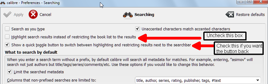

Sorry if this is a really silly question but somewhere among the many calibre updates the search function has gone from bringing up all answers to the search topic and NOTHING ELSE in the main screen which if I remember correctly you then clicked off the search to get back to viewing your entire library and it now searches and HIGHLIGHTS within the main screen in green - How on earth can I get back to a search only showing search results not highlights in green? I have a very large library and highlighting is no help.
Any help with this would be so very much appreciated.

Preferences / Searching. See the attachment for details.

You are my hero! Thank you so much!
