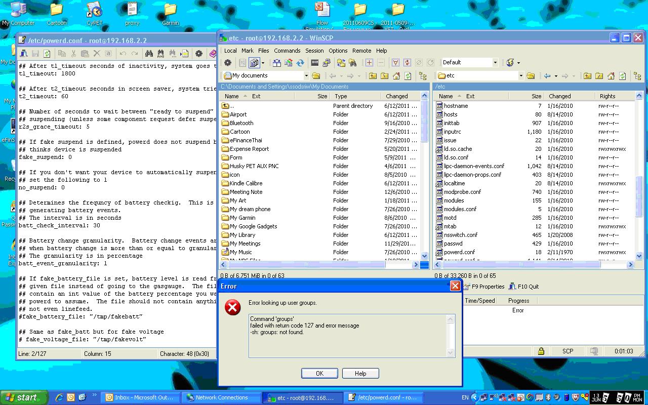

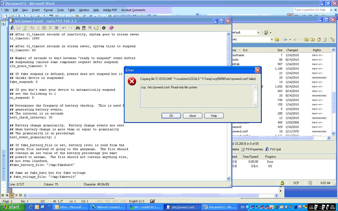

Hi,
I want to change the screen saver timeout from 600sec to 1,800sec.
Since no hack tool available for K2i v.2.5, I tried USBnetwork to access to powerd.conf file.
However, when I tried to save back, it says this file is system file.
Can anyone suggest how I can modify this file step by step?
PS: I use WinSCP to access the file with user:root / no password
Pics attached
Huh?
https://www.mobileread.com/forums/showthread.php?t=88004
Much of the Kindle's file system is mounted read-only (/mnt/us is not), so you need to remount as writable to make any changes to files.

Finally after I went through search to find the way to make the file read-write - with help of telnet and WinSCP, I can change the parameter and now my Kindle works perfect!

first mount the filesystem as RW (readwrite) by telnet:
mntroot rw
Use WinSCP to access the file and change the parameter
Once you're done, you should put the filesystem back to RO (readonly):
mntroot ro
You can also try to follow this link for some more detail "https://www.mobileread.com/forums/showpost.php?p=1181285&postcount=8"
