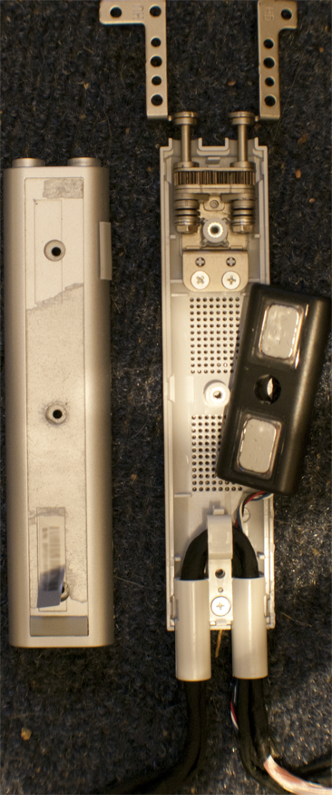

I've attached a picture of the inside of the hinge. Lack of switches suggests to me that the pocket edge uses a different method to detect when the lid is closed. On the lcd side of the unit is two magnets. One is beneath where the pen sits, so I suspect it is for charging it. But the other magnet sits on the opposite side of the lcd from the pen, and seems to have no purpose, unless the wacom sensor is able to sense it when the lid is closed.
I haven't been able to fix the lcd yet, though it seems that the touch sensor isn't working either, which gives support to it possibly being the lcd cable thats gone bad.

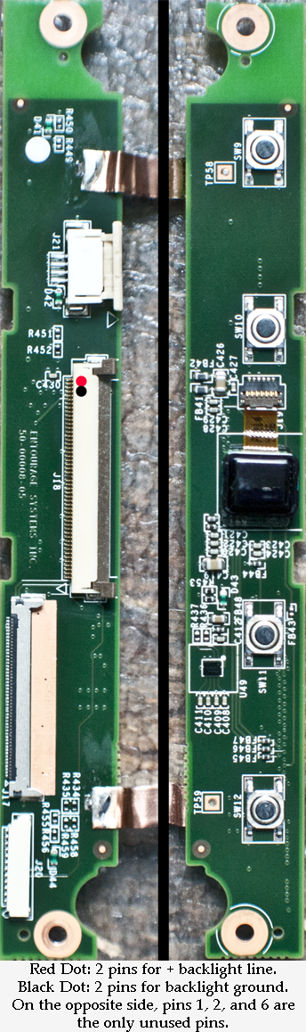

Attached is a picture of the pcb on the lcd side of the pe. The 4 pin connector is for the touchscreen.
I tested the backlight, and it still lights up, so its a chip/wire/trace somewhere on the board(s).

I don't think that board has anything to do with the backlight other than being a passthrough. If U49 is the chip you indicate then you will have to look elsewhere. The board appears to be multi layer so we can't trace the tracks but I am thinking the controller is most likely on the main board.
Next test would be to find out if the + line for the LEDs is connected to any other socket, the - will most probably be a common ground and unswitched. If it is, then you will have to trace where that goes.

I agree that u49 is most likely solely for the touch and maybe ir mouse and that the board is just a pass for the lcd/backlight unit. I tested and got the same voltage at both the lcd ribbon (where the backlight ribbon is soldered to the lcd's ribbon) and at the connector on the mainboard.
Attached is a shot of the connector on the mainboard. I labeled where the ground and positive pins are on the board for backlight. I tested the ground while the unit was unplugged from battery, and still got continuity.
