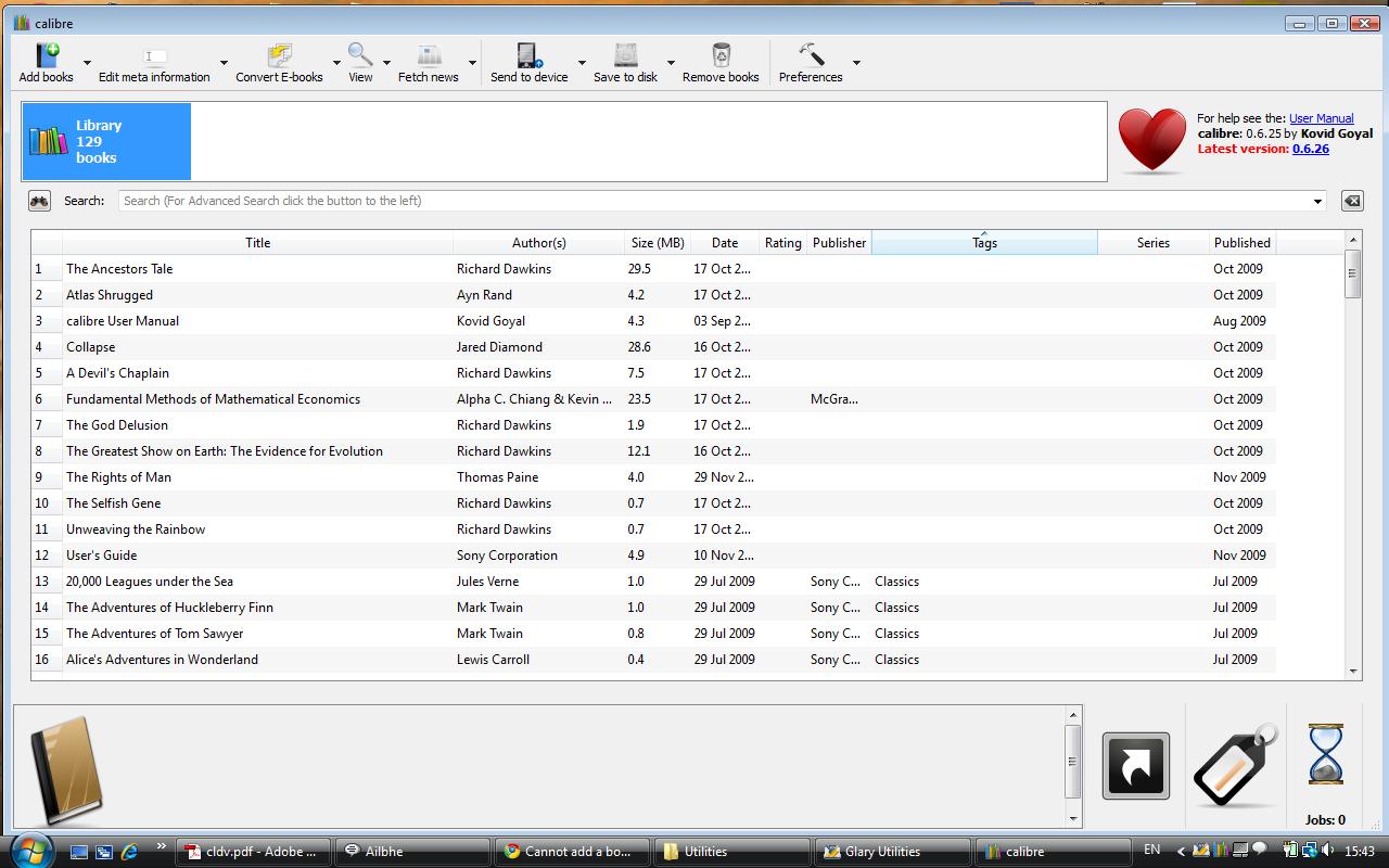

Yeah, I am definitely running 0.6.25. I can take a screenshot if you like!

Old 12-05-2009, 11:46 AM   #6
Posts: 45,639
Karma: 28549046
look in C:\Program Files for a folder named calibre and delete it if it exists. (Newer versions of calibre are installed by default in C:\Program Files\calibre2)

Old 12-05-2009, 11:47 AM   #7
daithi81
daithi81 began at the beginning.
Posts: 22
Device: Sony Reader PRS-505
Yes, that solved it.
