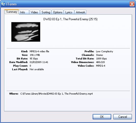

I've had a 1st Gen 32GB iPod Touch for a year or so, which I primarily use as a video player; all my video I convert to MPEG 4 format, which worked very well.
I've just bought the new 64GB 3rd Gen iPod Touch, loaded some of my video onto it, and discovered that when it plays, all I get is a solid green background.
A little experimentation shows that if I recode the video to use the "H.264" codec rather than MPEG4 it plays fine.
Has Apple actually documented the fact that MPEG4 is no longer supported on the new devices? It's a bit of a nuisance!

As I say, if I recode my videos for the H.264 codec rather than MPEG4, it works, so I do have a solution. It's just annoying that I have to do this for hundreds of hours of video!
What tools are you using to encode your video? Are you using a resolution less than 720x for MPEG4 (simple profile)? What extension are you using? Do your videos work in iTunes and not on the iTouch?
A lot of people try to bring over .avi (which is usually xvid or divx ) which is not supported by iTunes, even if it has an .MP4 extension.
If you're videos are sourced from the sharing sites they're most likely to be <720x pixels wide, Xvid with either MP3 or AC3 audio and the .avi extension. These will never work with an itouch without re-encoding.
You can find out exactly what kind of file you have by running it through the excellent Mediainfo, which can be downloaded from Videohelp.com
http://www.videohelp.com/tools/MediaInfo
Run one of your troublesome files through that and we'll soon get to the bottom of the problem

Here's what iTunes has to say about a file that doesn't play on the 3G Touch, and one that does. Both files play perfectly in iTunes, and the one that doesn't work on the new Touch works perfectly well on the old one, and on the iPod Classic.
Does this throw any light on the matter?
