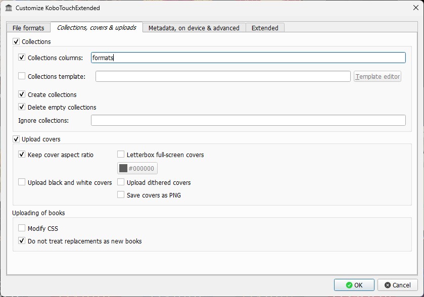

My suggestion is:
for books already on the device
inside kobo driver, on calibre, you can customize the collections on the device and show the books grouped that way
Name:	Screenshot 2025-01-03 181401.jpg
for newer books
I think the best option is to use metadata plugboard to insert the format on the title of the book or change the save template to include the format

The problem with this approach is that Calibre doesn't know which books you sent via the Extended Driver as kepubs and which as epubs. As far as Calibre knows, all books on your Kobo are epubs.

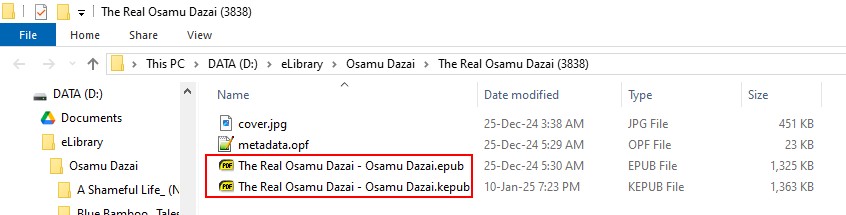

Right-click one of the selected books in Calibre to open the folder, and you will find the epub files and epub.kepub files in the same folder under the author name (if you don't change the default calibre directory)
In my case, I keep epub in Calibre library and send kepub to kobo using kobo touch extended.
