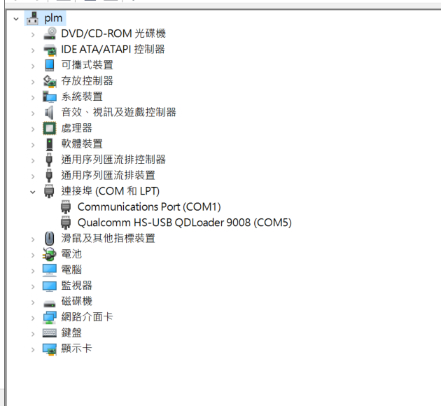

Old 09-18-2024, 02:57 AM   #5
aaron42195
aaron42195 began at the beginning.
Posts: 41
Join Date: Sep 2024
Device: Boox Note 3
Name:	螢幕擷取畫面 2024-04-30 074904.png
Name:	螢幕擷取畫面 2024-09-18 135548.png
Is this edl mode?
aaron42195 is offline   Reply With Quote

Old 09-18-2024, 04:58 AM   #7
Renate
Onyx-maniac
Posts: 4,154
Karma: 18764971
Originally Posted by aaron42195 View Post
Is this edl mode?
Yes, but I don't like QFIL and virtual com ports (or Python).
