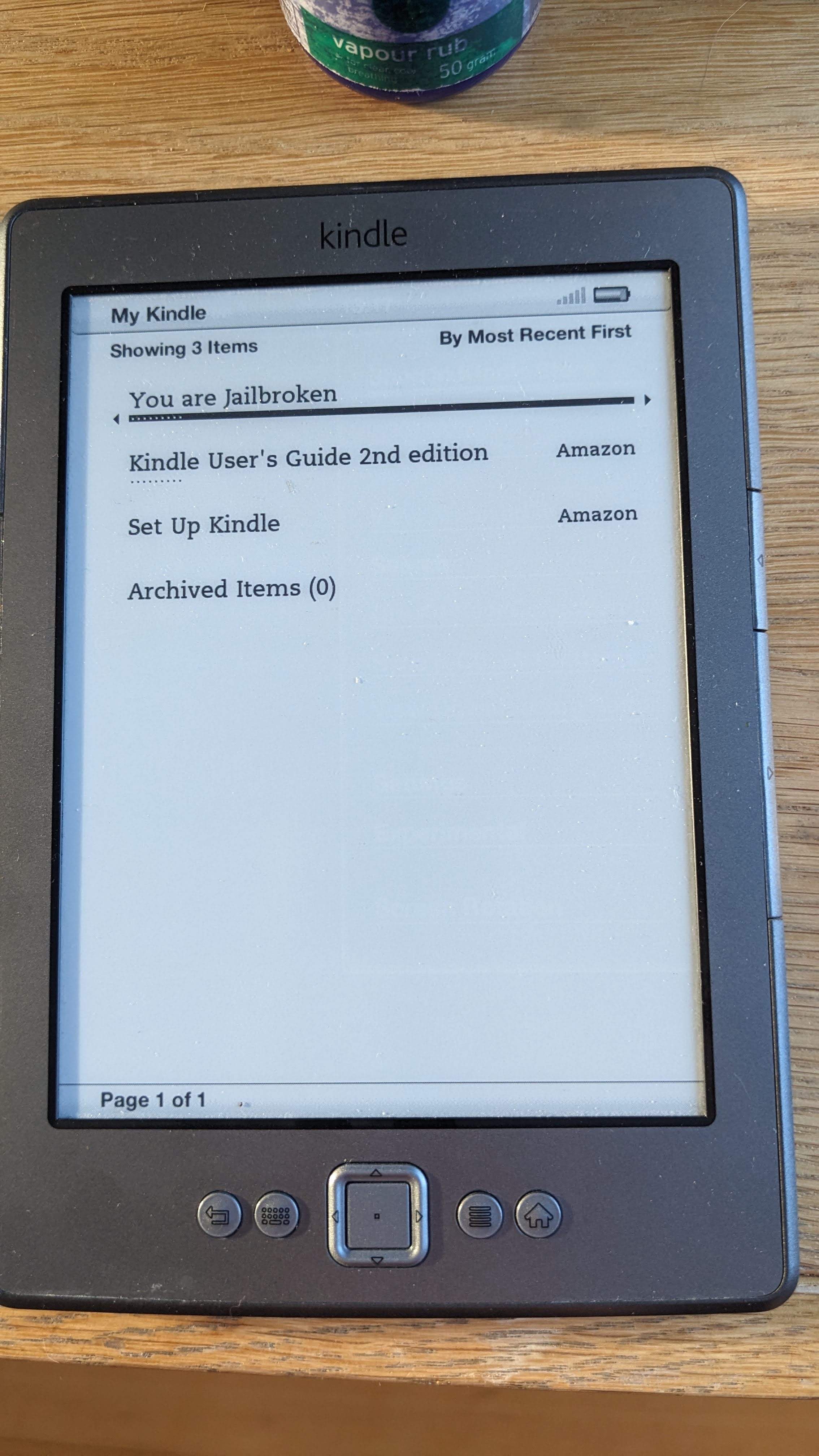

1. Jailbreak worked.
I have successfully followed the jailbreak guide on https://www.mobileread.com/ to the point where i now have an entry reading 'You are Jailbroken' at my main Kindle screen.

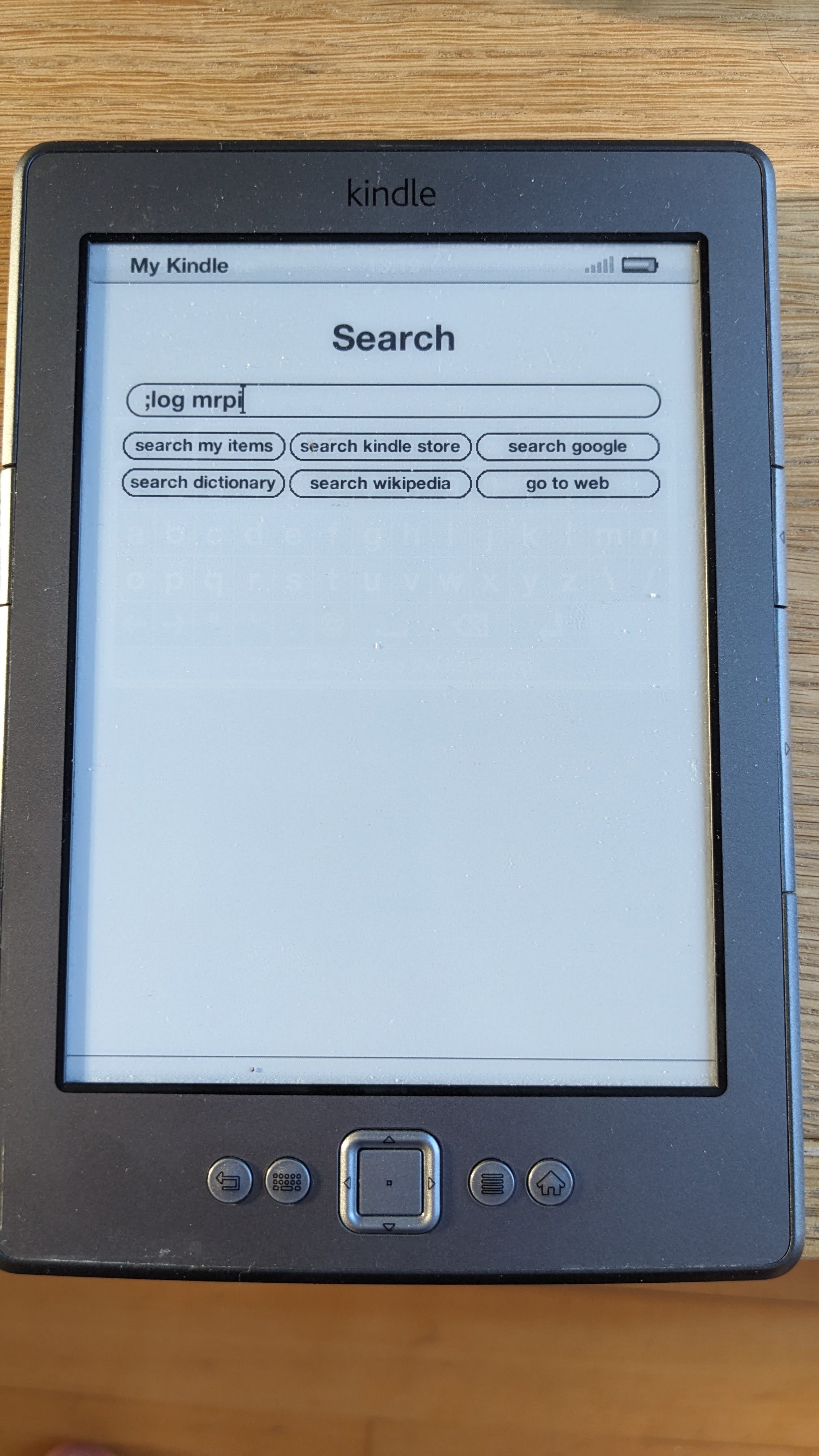

When i try Step 5:
"eject/disconnect your Kindle, then enter ;log mrpi to start MRPI. "

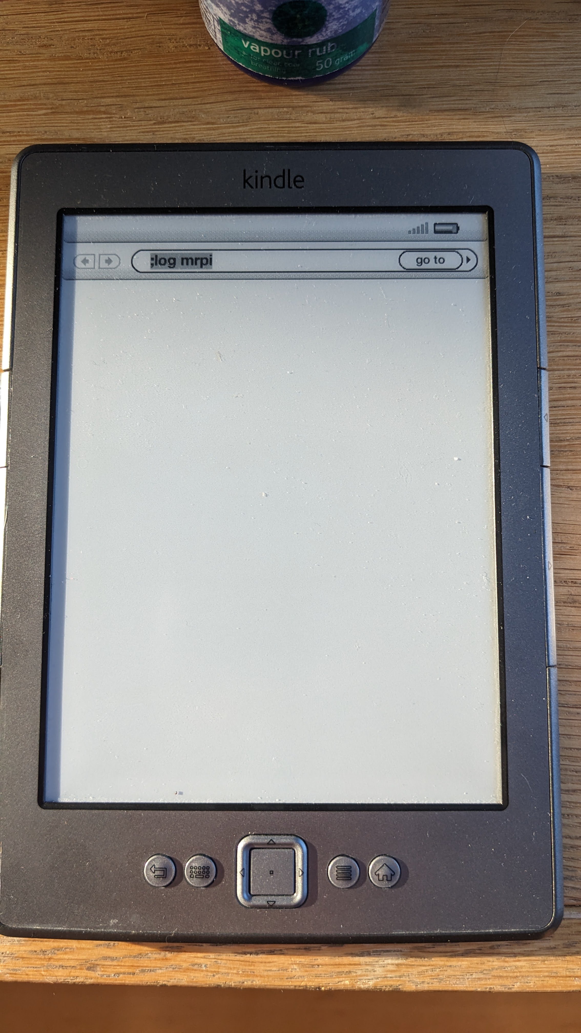

Its not clear where i enter ";log mrpi" The Search bar has 6 options for search that dont seem to be referenced in any guides I can find.
I've seen references to running 'search' commands starting with ; in other guides, I'm unable to get anything to submit in my search box, it just asks where i want to search.
What am I not doing right here?
Thanks for any help!

That KUAL installation guide is for newer Kindles. To install it on Kindle 4, all you have to do is copy the KUAL-KDK-1.0.azw2 file from the KUAL archive to your Kindle's documents folder.

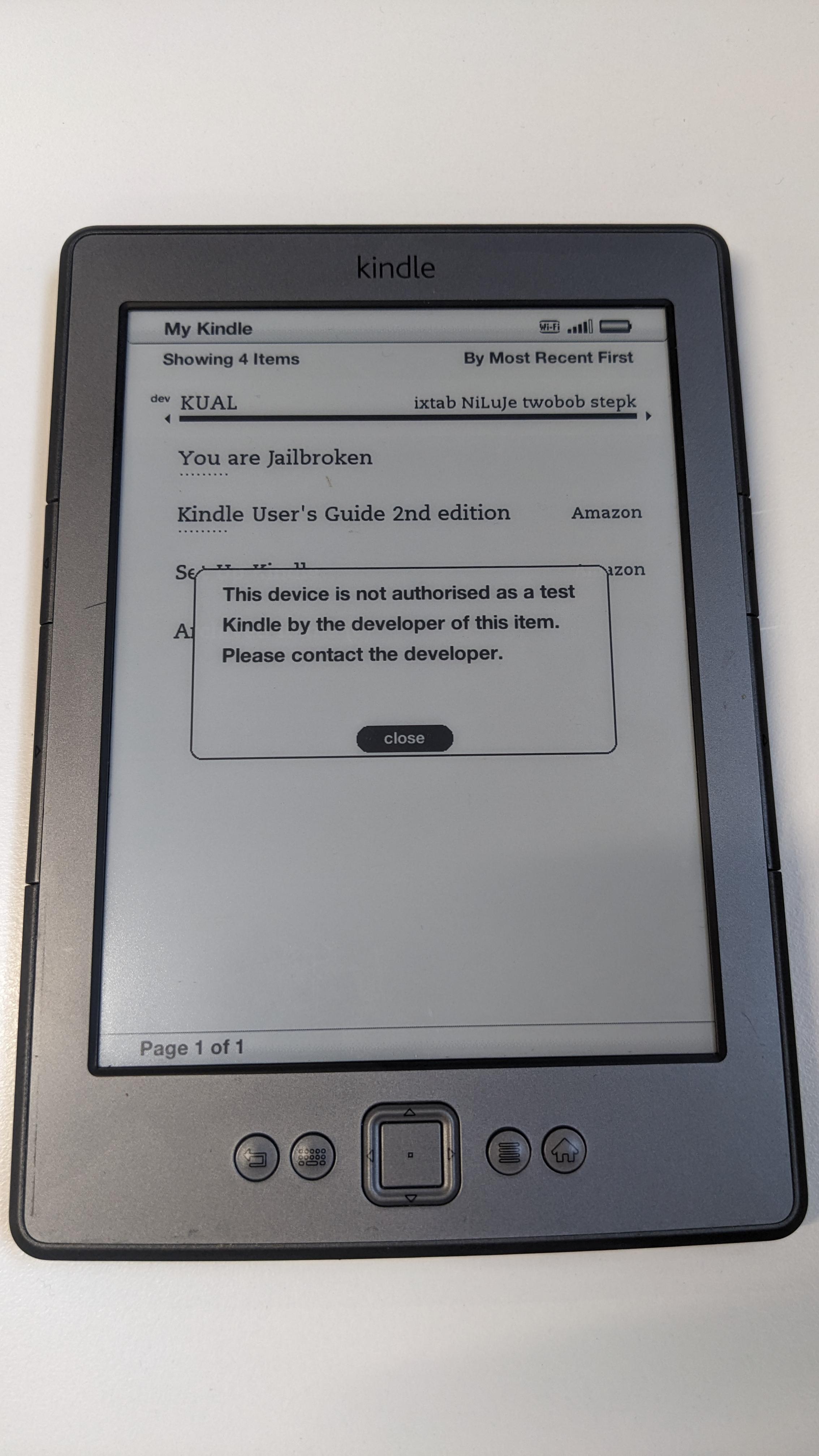

On the final step 6, I try to open KUAL, to launch the 'Kindle Weather Stand'. KUAL now will not open. Instead I get error: "This device is not authorized as a test kindle by the developer of this item. Please contact the developer."
I have tried generic advice for this error reinstalling MKK and everything else. I have done this, but still cannot get KUAL to open.
Any advice would be most welcome. I feel like I'm very close to getting this working now!

Testing with just the K4jailbreak and KUAL installed, I only get the error when connected to Wifi. I also get a new 'book' showing after connecting to wifi "Test Kindle Installation Result".
As mentioned, the error I get when opening KUAL is: "This device is not authorized as a test kindle by the developer of this item. Please contact the developer."
The error still occurs after disconnecting Wifi, so it seems that on connecting wifi, its changing something that doesnt allow KUAL to open. I get the error even when I connect to wifi, before installing the jailbreak and KUAL.
Without having connected to Wifi, I can open KUAL as normal.

Hi there, I believe i have found the solution - annoyingly I cannot get it to work but thats another matter. I'll share my findings in case it helps someone stumbling across this thread:
Looks like the error with KUAL was/is caused by "OTA updates" when you connect to wifi. This can be prevented by installing Helper+ through KUAL (without wifi enabled). However, i understand this may not be a permanent fix.
Instead, downgrade your firmware from 4.1.4 back to 4.1.1 as apparently OTA updates arent a problem on this FW... This user had the same experience:
https://www.mobileread.com/forums/sh...d.php?t=352957
I'm calling this problem solved. Hopefully I get around to actually applying this fix and getting it working myself.
