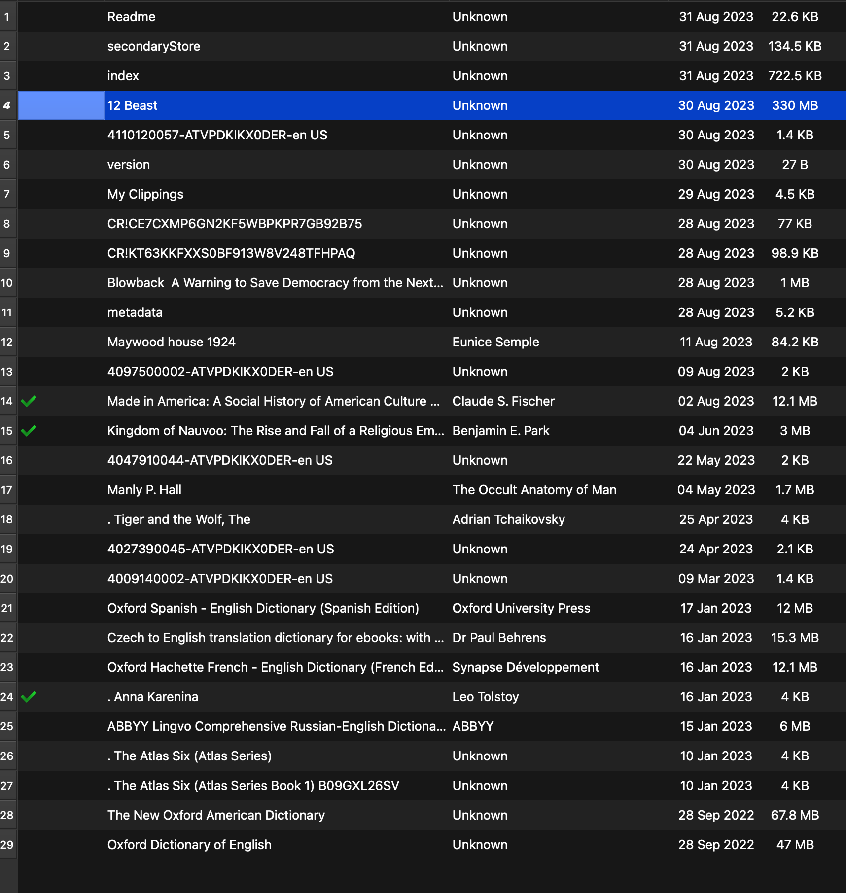

Kindle Scribe no longer connects as USB drive
Update 5.16.3 includes this Scribe-only 'feature':
Connect Kindle Scribe over USB using Media Transfer Protocol (MTP) instead of emulating a disk drive.
Connecting via USB no longer shows as a USB Drive (removable volume in Finder, a drive volume in Windows Explorer). As it is not mounted in file system, there is no access via command line. Mac requires third party MTP client like Android File Transfer to manage content. Another inconvenience is that only one MTP client can connect at a time. I don't know if this is also true on Windows. It also causes issues on Linux but I don't have one set up to be able to describe what these are.
Disconnect is done by tapping Disconnect on the Scribe.
Calibre evidently knows MTP, so it still connects and shows content, is able to Send to device, etc.
However, calibre Show books now displays items which are normally filtered out (by calibre?) or hidden with '.' filename prefix on an emulated FAT32 partition. (see screenshot). Matching to In Library does not always work correctly because of this (see '.Anna Karenina'). Also some .kfx content inside of .sdr folders, html files in /System folder, readme in /fonts folder etc..
Of course undocumented ebook-device command line tool does not work with Scribe.
Kindle 10th and 11th generation also got this update, but still mount to file system as before. Without knowing Amazon's motivation for making this change, it seems as likely as not that they might get this 'feature' in the future.
So some sort of fix is needed for Scribe. I will be happy to provide more information if any is needed. Thanks.

The issue is that calibre is showing content items that is not really user content, i.e. that you would not see it when viewing Library on Kindle. This stuff should be filtered out, and then the actual user content matched to calibre content to determine what is In Library.
Apologies if I'm not using the correct technical terms.

The problem is that calibre has special handling for Kindle devices. It knows about the Kindle-specific folder layout and file formats found there.
When the Scribe is detected as an MTP device it is not treated as a Kindle but instead as a generic device that might have book files of any type anywhere in storage.

But files whose names start with . are not ignored. There is no good reason to do so. Where are they coming from?
Old 09-01-2023, 12:59 AM   #7
Posts: 45,617
Karma: 28549044
Ah those ._ are the infamous appledouble files. They will have been created by apple software in the past when the device wa a USB disk. Just delete them once and they will not be recreated since the device is now an MTP device.

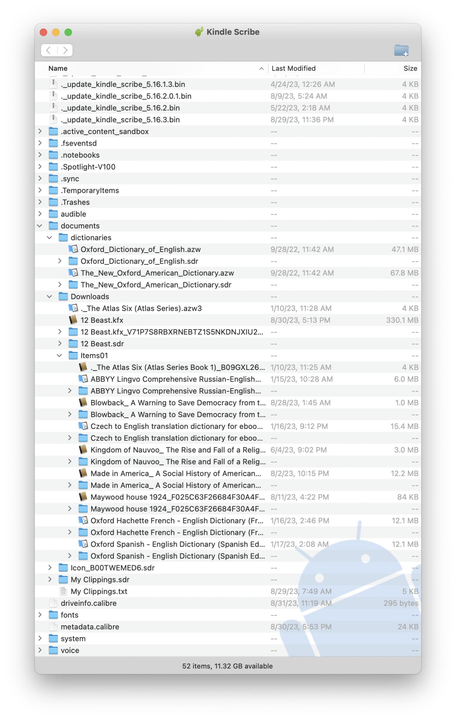

.Anna Karenina (and the other one) are also Mac artifacts, in .Trashes/ folder.
So I have deleted those as well.
Well there's at least some upside to the change: won't have this junk in the future!

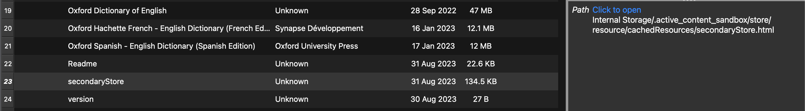

Looking at your changes, I think we may need to add .active_content_sandbox to folder ignore list, it is picking up a couple of .html files in there.

No need one of the changes was to ignore all top level folders starting with .
