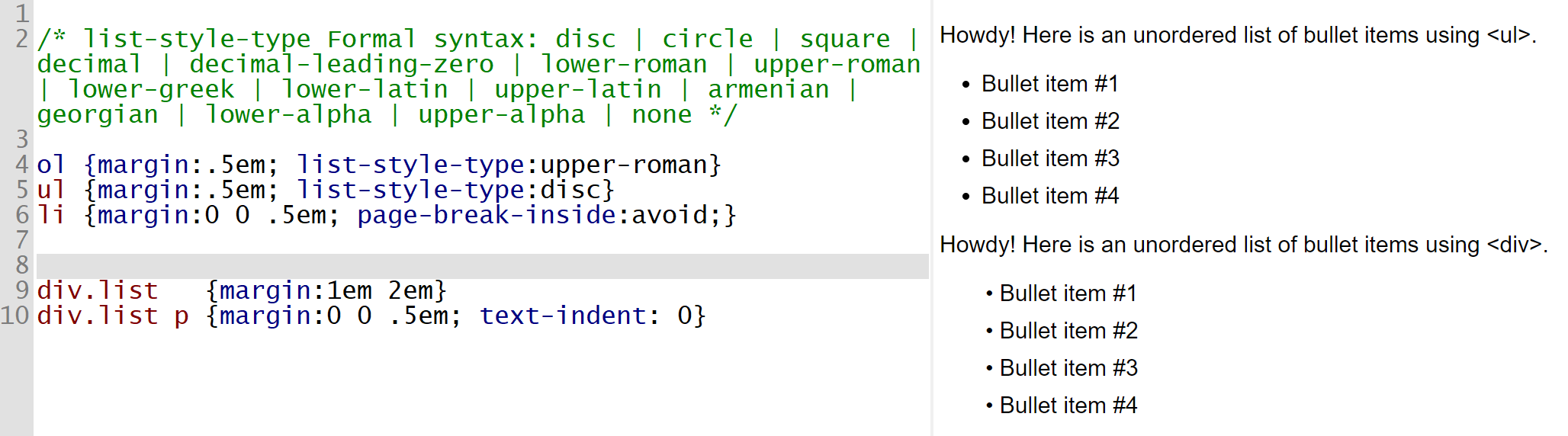

For example, I used the following css on a style sheet to make a list of paragraphs look just like the unordered list. (see attachment)
/* list-style-type Formal syntax: disc | circle | square | decimal |
decimal-leading-zero | lower-roman | upper-roman | lower-greek |
lower-latin | upper-latin | armenian | georgian | lower-alpha |
upper-alpha | none */
ol {margin:.5em; list-style-type:upper-roman}
ul {margin:.5em; list-style-type:none}
li {margin:0 0 .5em}
div.list   {margin:1em 2em}
div.list p {margin:0 0 .5em; text-indent: 0}
Name:	Screenshot 2023-09-12 115340.png
One of the main benefits of using a css sheet is that I only have to change/update/fix the styling in one location and it is applied throughout the document...much faster!
If I wanted to add a list style I could change 'none' to 'disc' on the css file to update all the <ul>s at once, but I'd have to manually add the disc symbol to every paragraph if I used the <div>. (note: there is a way to automatically add the disc image in front of the <p> in each <div> using css but that is beyond the scope of the question and the OP's experience level.)
