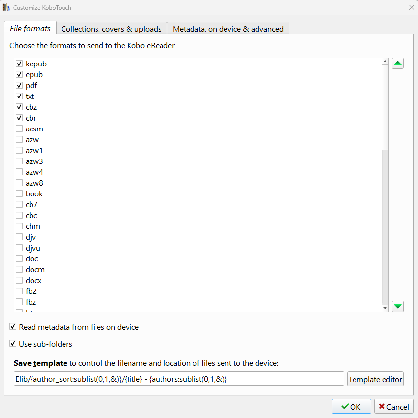

Where are you sending the kepubs to on your Clara HD? What is the template you are using in the KoboTouch driver? I've attached an image of the first configuration page for the KT driver as I have it configured.
When you mount the device on your computer, can you see the kepub file in Finder? What version of calibre are you running? You mention 7.7.1 but that is not a calibre version (6.25 is currently the latest version and it should run on your machine).
The only reason for disabling the KoboTouch driver would be if you were using the KoboTouchExtended driver which will convert epub to kepub as they are sent to your Kobo.

Posts: 48,929
Karma: 174631582
If you are using KOReader and not sending the books to a location accessible by Nickel (see the excluded folders item (in .kobo/Kobo/Kobo eReader.conf, look for the [FeatureSettings] header and under it, ExcludeSyncFolders=\\.(?!kobo|adobe).*? for example.), Nickel is not able to access the books and it will not import them to the database.
Again, this comes down to where you are copying the books to. If you are using only KOReader to read, why bother sending kepubs since only Nickel will make use of the extra spans and so on. Perhaps not using the KoboTouch driver and using the generic driver instead would be better suited to your purposes.

Old 08-28-2023, 06:55 PM   #15
Posts: 48,929
Karma: 174631582
Originally Posted by Gurgling2791 View Post
I currently have
ExcludeSyncFolders=(\\.(?!kobo|adobe).+|([^.][^/]*/)+\\..+)
Calibre is putting the books in /mnt/onboard right now. Though I would like to change that... not sure how to do so to be honest.
If you look at the image I attached earlier for the KoboTouch driver, the Save template controls the addition of books to the Kobo ereader. My current template is:
Elib/{author_sort:sublist(0,1,&)}/{title} - {authors:sublist(0,1,&)}
Elib is a directory in the root of the exposed partition. Inside that a directory is created based on the first entry in the author-sort list (this keeps the file paths shorter) and the file is created with the filename as title - first author in the author list (again, this keeps the file paths shorter).
There are limits on the number of directory entries in the root of a FAT32 partition which is why I use the Elib directory.
