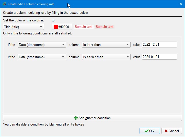

You don't say where you are getting the "added date" so I used calibre's 'date' field. This rule colors the title column red if the calibre date is in 2023.

Take a look at the image in the message from @chaley.
Pay special attention to the two lines starting with Date (timestamp) after the line that says Only if the following conditions are all satisfied.
The first conditions says if the date is after 2022-12-31, the second condition says if the date is before 2024-01-01. So basically, if the date is from 2023-01-01 to 2023-12-31, the column will get the colour.

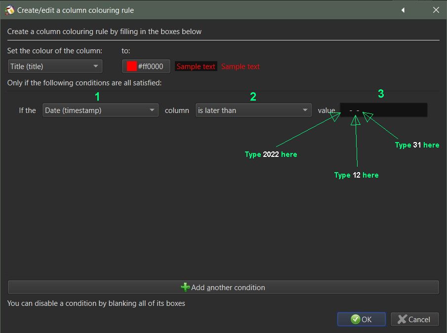

After selecting the column to be coloured (e.g. Title), and a colour
  1. Click on the "If the" box and select a column on which to base decision (e.g. "Date (timestamp)")
  2. Click on the "column" box and select condition (e.g. "is later than")
  3. In the third box enter a date in yyyy-mm-dd format (e.g. 2022-12-31)
  4. Click "Add another condition"
  5. Repeat steps 1-3 but select "is earlier than" and enter 2024-01-01
  6. Click OK

The hyphens are 'pre-positioned' as a guide, so you have to sort of type around them - So:
type '2022'; the cursor should now be after the first hyphen,
type '12'; the cursor should now be after the second hyphen,
type '31'.

You must select/enter the three values in order - the name of the column, the condition to apply, and any required value - the only conditions that allow a yyyy-mm-dd date value are: is earlier than, or is later than.

Click this ==>> Click image for larger version
Name:	Screenshot 2023-06-25 132600.jpg
