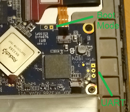

Hi Matthias and other users who posted here. Have been abandoned this for a while. In the meantime I achieved to dismantle the boox and also bought a battery, which arrived this morning.
Made some photos to show to you all how I did it and how it looks, although there is the post of matthias which also shows it. In my case, I use the triangular-sferic hard plastic tool use for this kind of electronic devices, but have had to go very carefully, because one of theangle's got kind of broken. I show to you the place I start using it, and then it's just keep going. You can help your self of another hard plastic tool (or a wide plane srewdriver) to prevent the case of closing itself when you are struggling on another part of the case.
Here it was my starting point:
Here is how morbidy inflated it was the battery:
And now I replaced the old 2800mAh battery for a 4200mAh, so I think it will be eReader for years.
See you, guys and ladies
Hope this is usefull to someone, someday.

Karma: 19000001
Thanks! It's always interesting to see the gizzards of these things.
Although Onyx has moved on from Rockchip and I know nothing about their boot modes, still I note the clearly identified UART and the probable boot test points.
