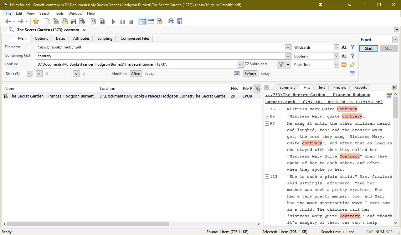

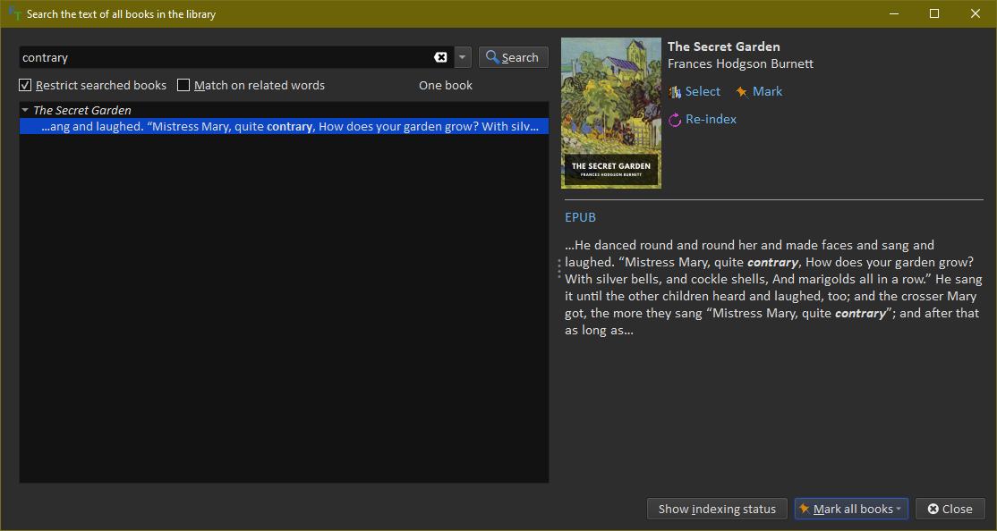

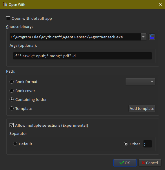

When I want to do additional searching, I use 'select all matched books' and then action chains 'open with' action to pass the folder paths to Agent Ransack (alas, epub search is a paid feature).
Name:	2023-02-10 06_17_20-Open With.png
ID:	199609   Click image for larger version
Name:	2023-02-10 06_22_28-Search the text of all books in the library.png
ID:	199610   Click image for larger version
Name:	2023-02-10 06_23_11-1 files found - Search_ contrary in D__Documents_My Books_Frances Hodgson Bu.png

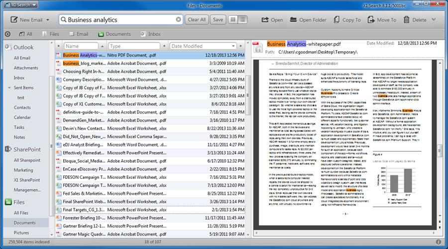

The X1 Search application will display highlighted text in a preview panel. It can index and preview DOCX, PDF, XLSX etc, but not ebook types like EPUB, LIT etc. Its primary target is large multi user environments.
I used X1 for a while on a business development project, when the project became a LOB function we outsourced it to a 3rd party. When X1 switched to SaaS pricing I decided I could live without it. We hooked X1 into calibre via the Drop Search Results plugin, which also works with similar tools like Windows Search, File Locator Pro, etc.
I've attached a screenshot from the X1 site.
