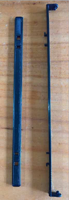

-original 2 part spine or printed ones (left is the "lower" and right the "upper" part)
Name:	Spine gedruckt.jpg

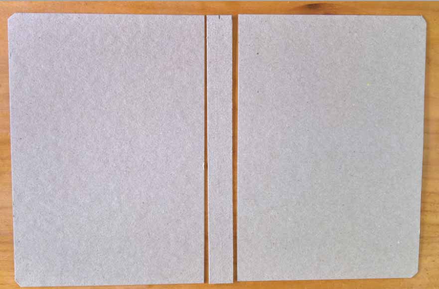

1. Cut the cardboard matching the old cover

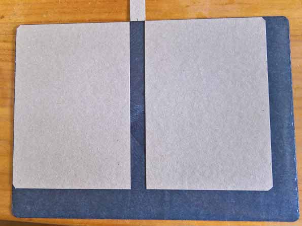

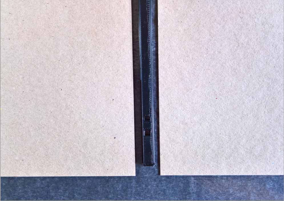

2. Place the two cardboard parts on the sticky faux leather with a space in between (for the spine and the folds)

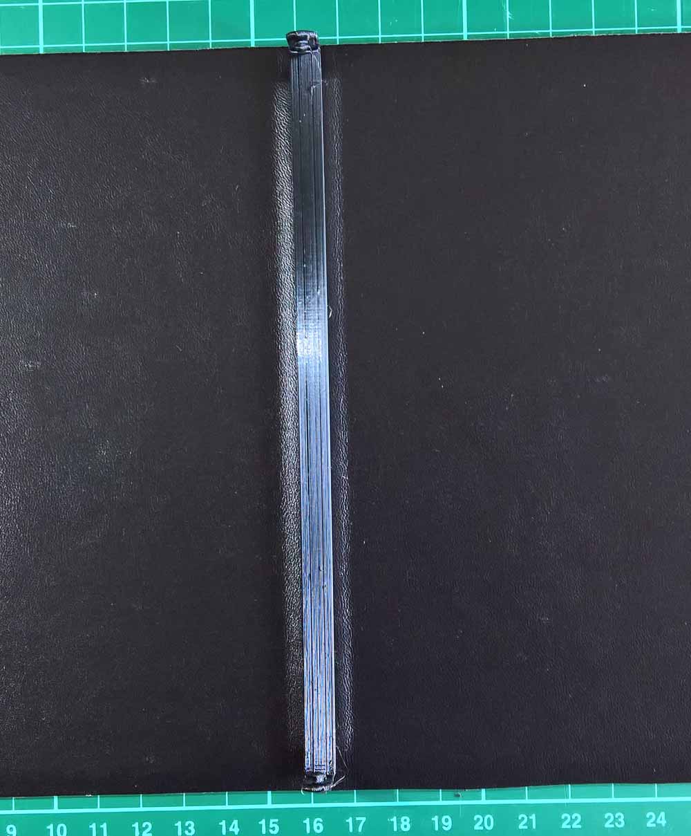

3. Place the lower part of the spine in the middle between the cardboards

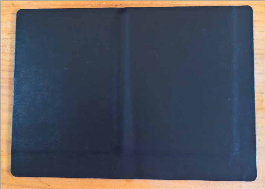

4. Cover everything with a second sheet of sticky faux leather, you see the bulge of the spine in the middle better in one of the next pictures

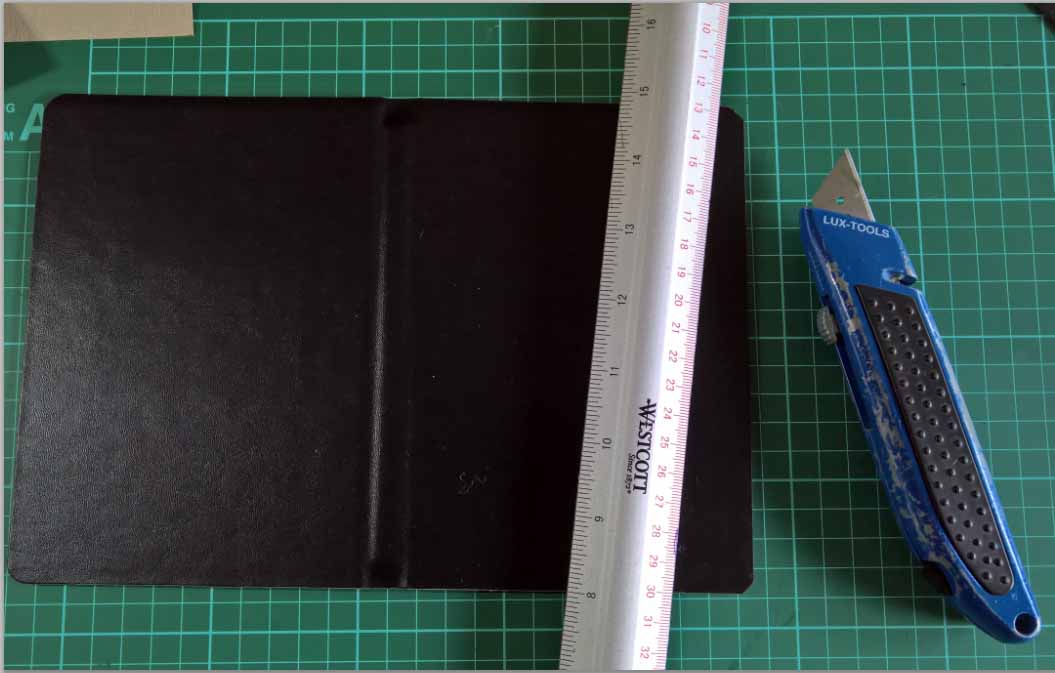

5. Cut the overhangs

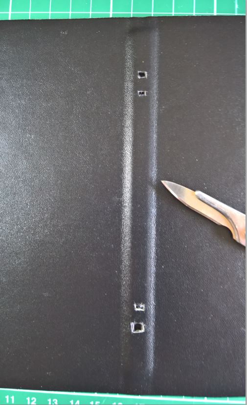

6. Now you have to cut holes in the sticky f. l. to free the holes in the lower spine. In the picture below I used a second spine to localize the holes
7. Holes

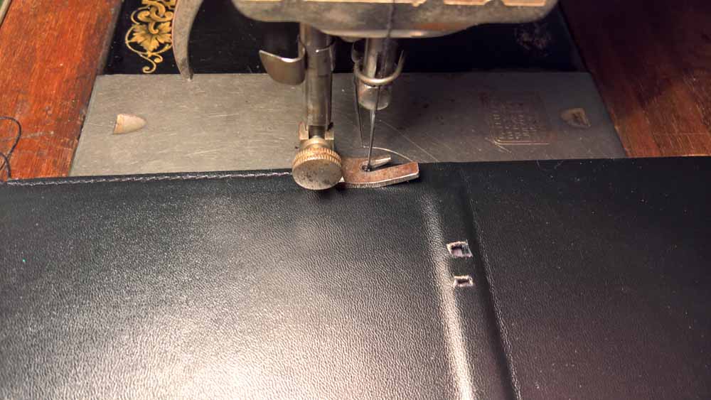

9. Remove the upper part of the spine to sew the margins. I did that to prevent the fraying of the edges and because it looks good (in theory...)

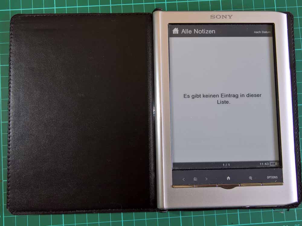

10. Okay, some problems: my cardboard is a little bit small because I forgot the width of the spine itself, when I measured it, and the seam is not very good because the thread tension was too low, although I had tried the seam on the leftovers, but here it is:
I printed the spine with nylon. Time will tell if everything is stable enough.
