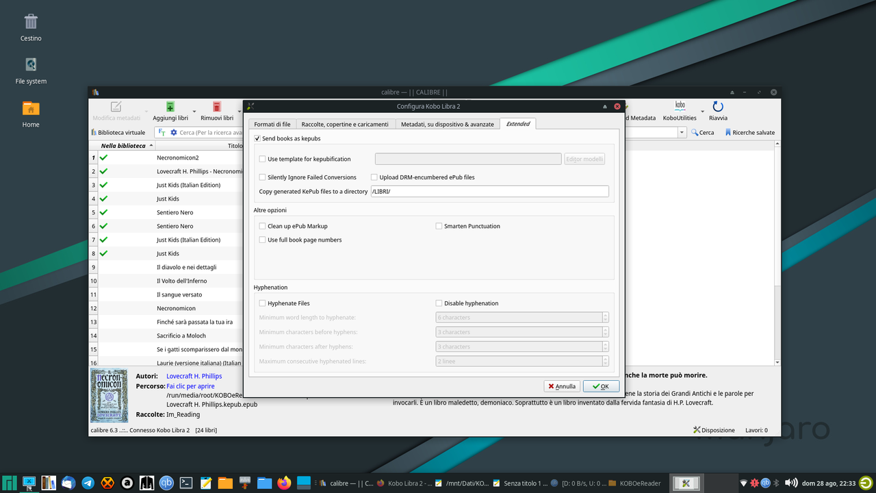

Hi theducks, I've not Send to Folder, just Send to device shortcut. I've tried to set the desired folder with this menu:
https://i.postimg.cc/SRzVKThW/kobo-e...d-settings.png
Sorry, my english is poor, so I put some screenshots in order to make you understand my requests.

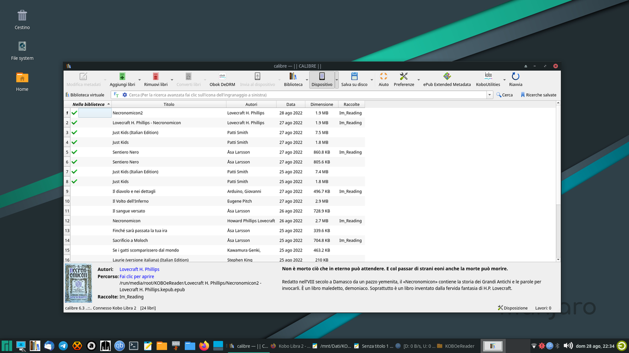

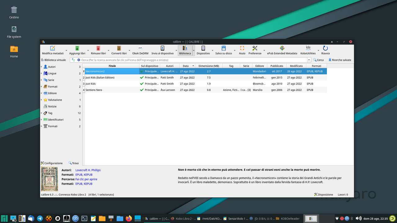

I need to see the book extension because I'm making various conversion tests in order to find the best configuration for read ebooks, according to my preferences.
https://i.postimg.cc/NMZSbrGk/Calibre-Library.png
https://i.postimg.cc/rm4QVZc5/Kobo-Library.png

Edit: finally I can send books on desired folder, after following your suggestion. Now my template is: /LIBRI/{author_sort}/{title} - {authors}

Format column is still missing from Device library form, can't find how to add it.

You can't change the columns in Device View
