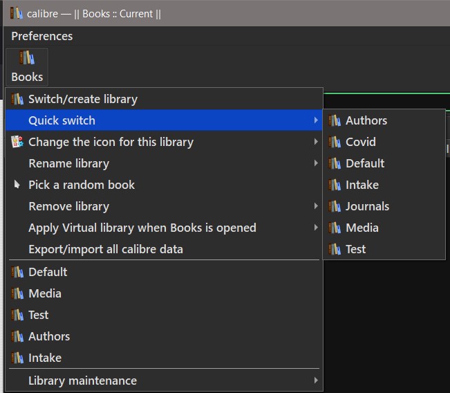

right-click the Library icon: Switch/create: USE EXISTING
after it has shown the library, it will appear on the quick switch list ONLY when viewing another library.
Your Library name is the base folder name: Avoid confusion, make them different

Originally Posted by 4denise View Post
Hi! I have 12 libraries in Calibre. The problem is that the list that comes up when I try to change libraries will not hold that many. I really need to switch to a library that is not shown in that list.
The libraries are all in Calibre. I have used them all.
Use the Quick switch action, you should get a list of all your libraries… except the one that's currently open… in alphabetical order.
