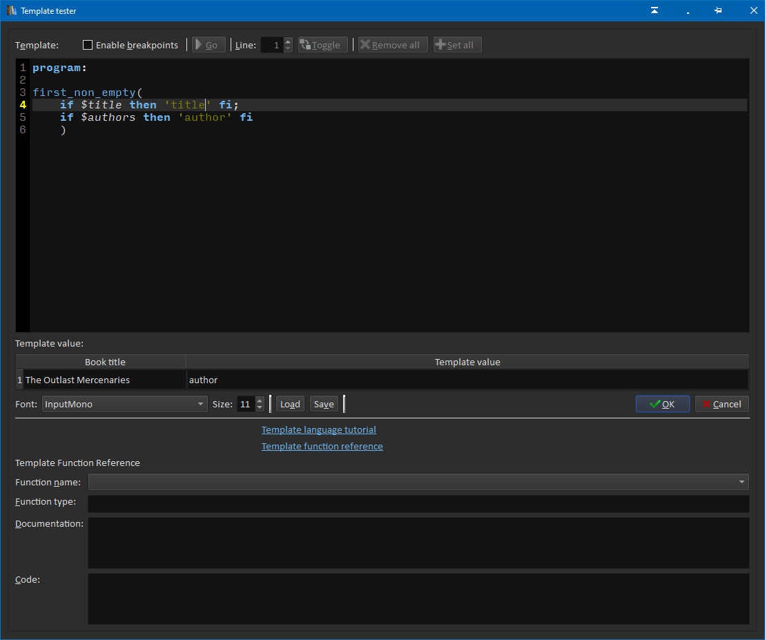

I also got some strange results on a far simpler test template:
Name:	2022-01-29 04_45_56-Template tester.png

update: I should have used commas instead of semicolons. It was apparently just one long entry in first_non_empty instead of a bunch of them. That was a silly mistake.
