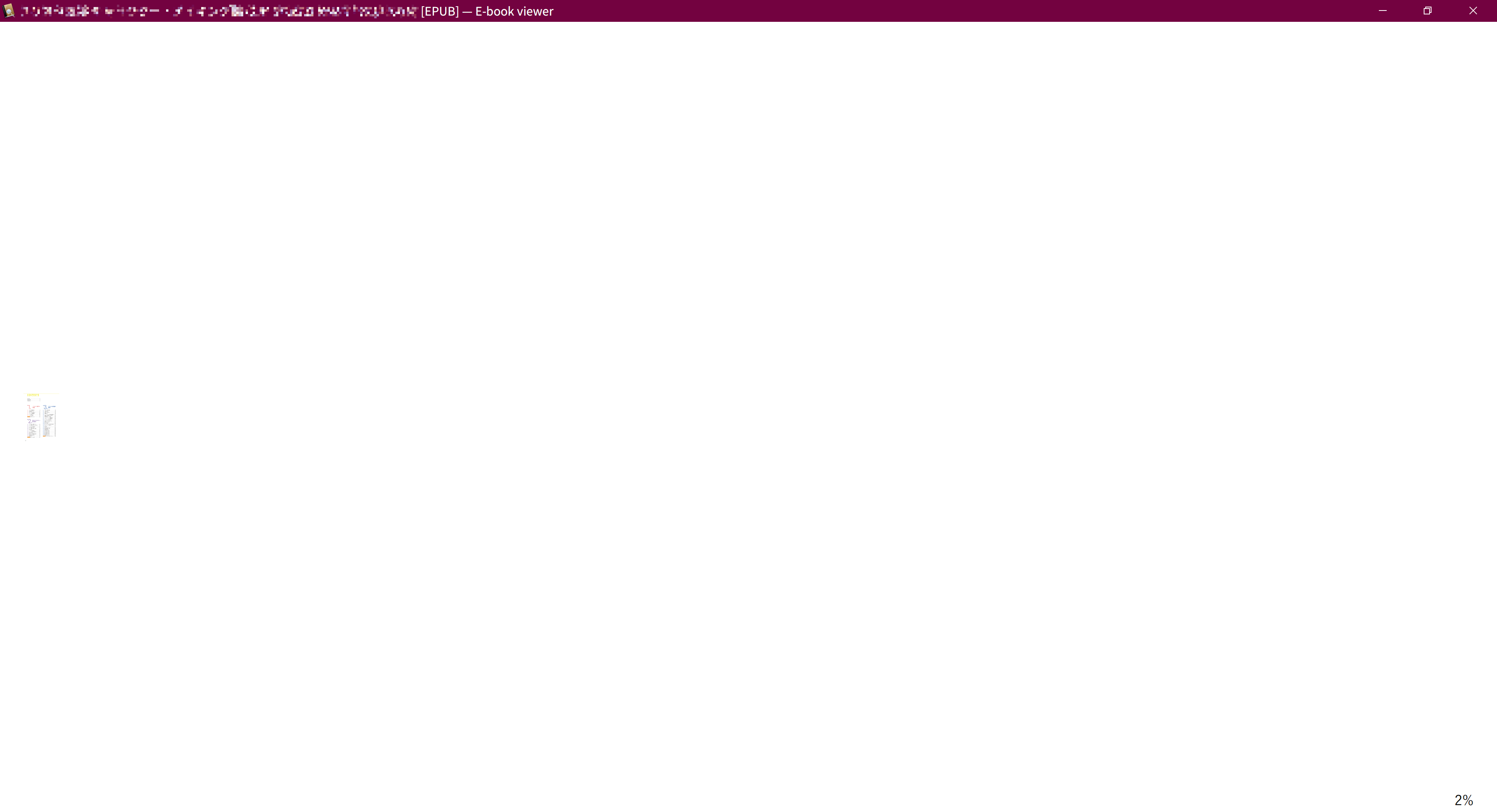

I have 4 EPUB books that just contain images. They all have the same problem so I suppose it's a problem for the viewer.

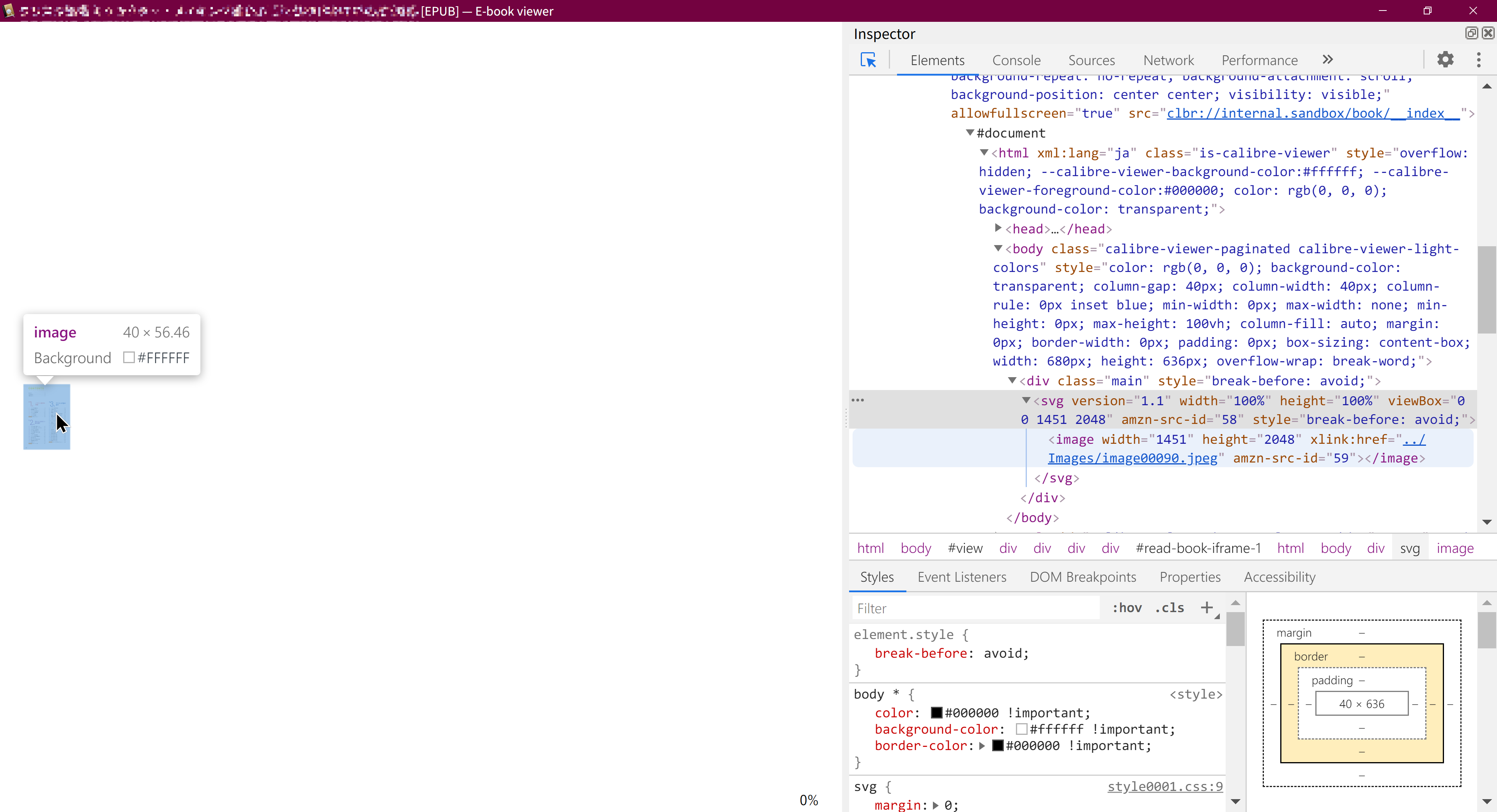

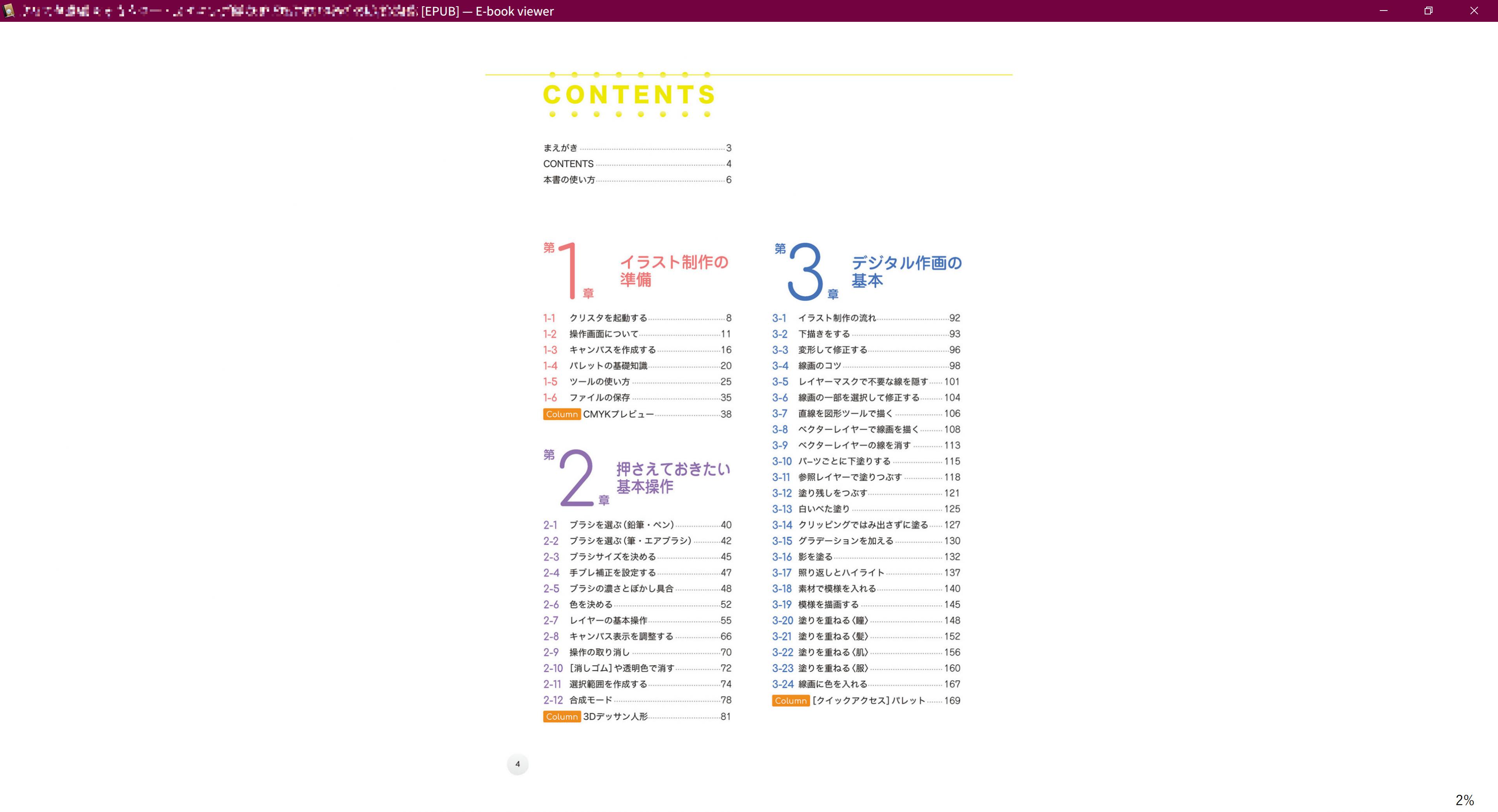

The image is so tiny when the paged mode is enabled (see picture 1). However, if I turn flow mode on, the image can fit the window size (see picture 2). And picture 3 is the code.
I want to read 2 pages at the same time so I need to use paged mode. My configuration is the default. What can I do to fix it?

This will be a fixed layout epub these are not supported in calibre. If it is just a collection of images then simply rename it to cbz and view that.

I see. After setting the column number in landscape mode from 0 to 2, the image can fit the window but there is only one image on the left. I guess I'll just use CBZ.
