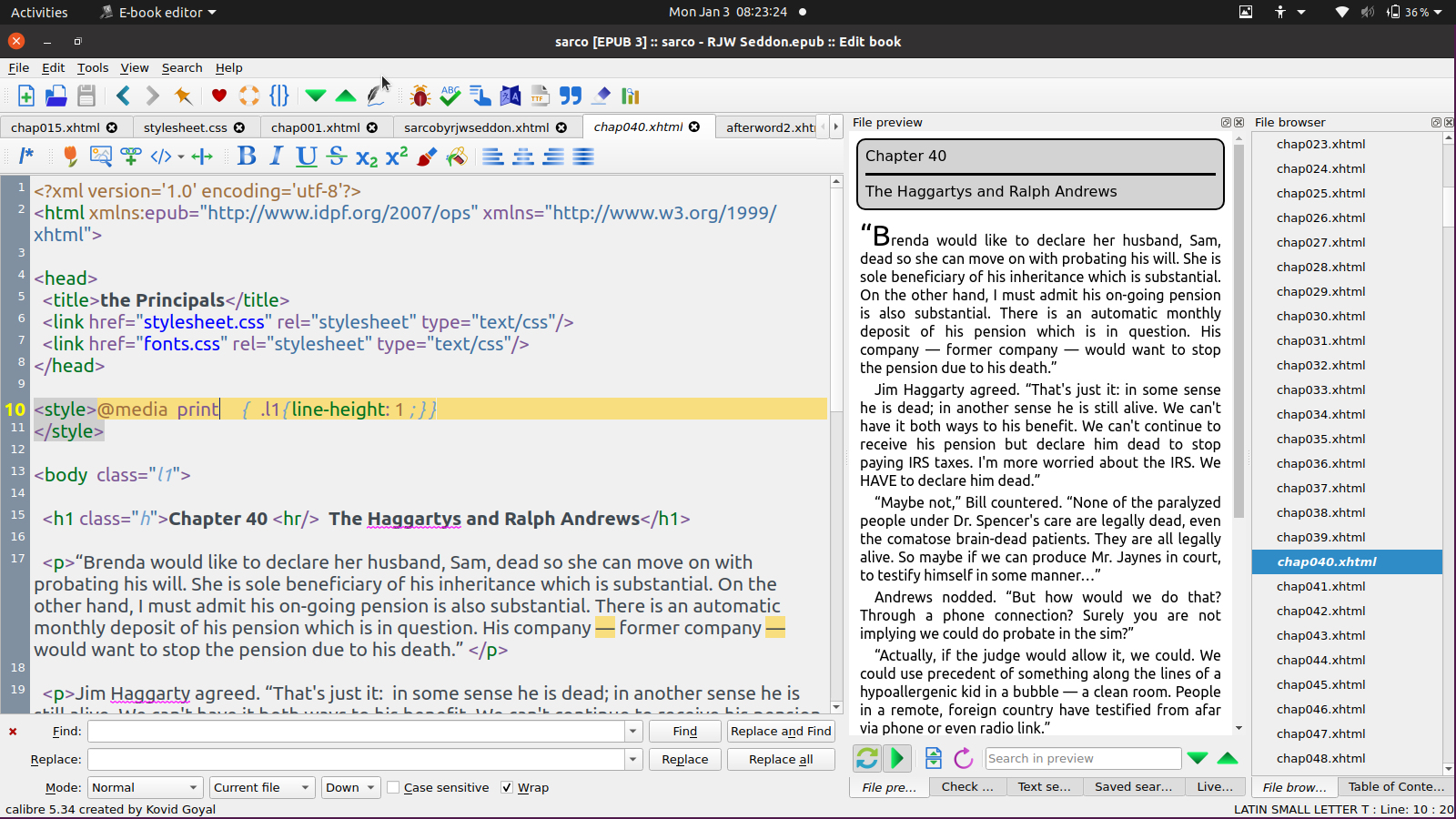

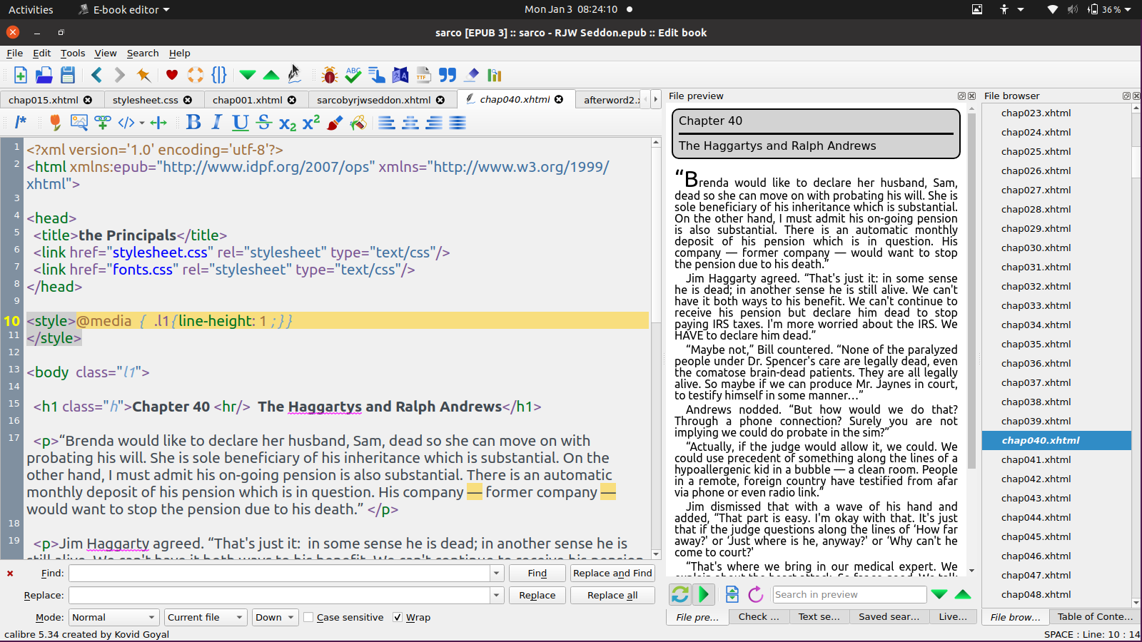

Please excuse my confusion. I put the style command
<style>
@media print {.l1{ line-height: 1 ; } }
</style>
along with <body class="l1"> in an xhtml segment which is a free-standing chapter. At print, I was hoping the line height would be reduced from 1.3 to 1 so that there would not be a straggler line left over. If I remove the word 'print' PDF conversion AND epub viewer reduces line height to 1. I was hoping for an instruction only honored during print. Best regards, Pop

There's no way to control that from within the book. You can specify your css rules during conversion in the Look & feel->styles section of the conversion dialog.

thank you for that. It works wonderfully well. I do not even need @media. I lost sight of forest for the trees. Best regards, Pop
