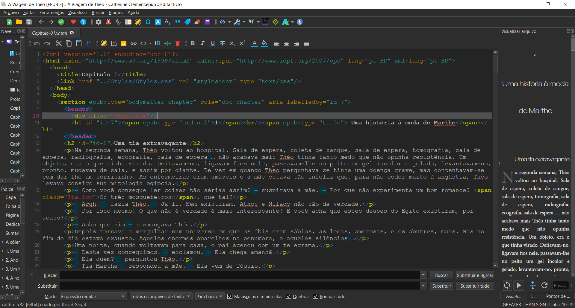

Hi I hope somebody can help, because it's driving me crazy. every time i open the editor the user interface is incredibly annoying. the sidebars are sized so i can effectively can't work with it and have to drag them back in place.
Most of the time i have to open multiple files, and every one i open it is back to the annoying dimensions.
is there a way to change or lock the borders?

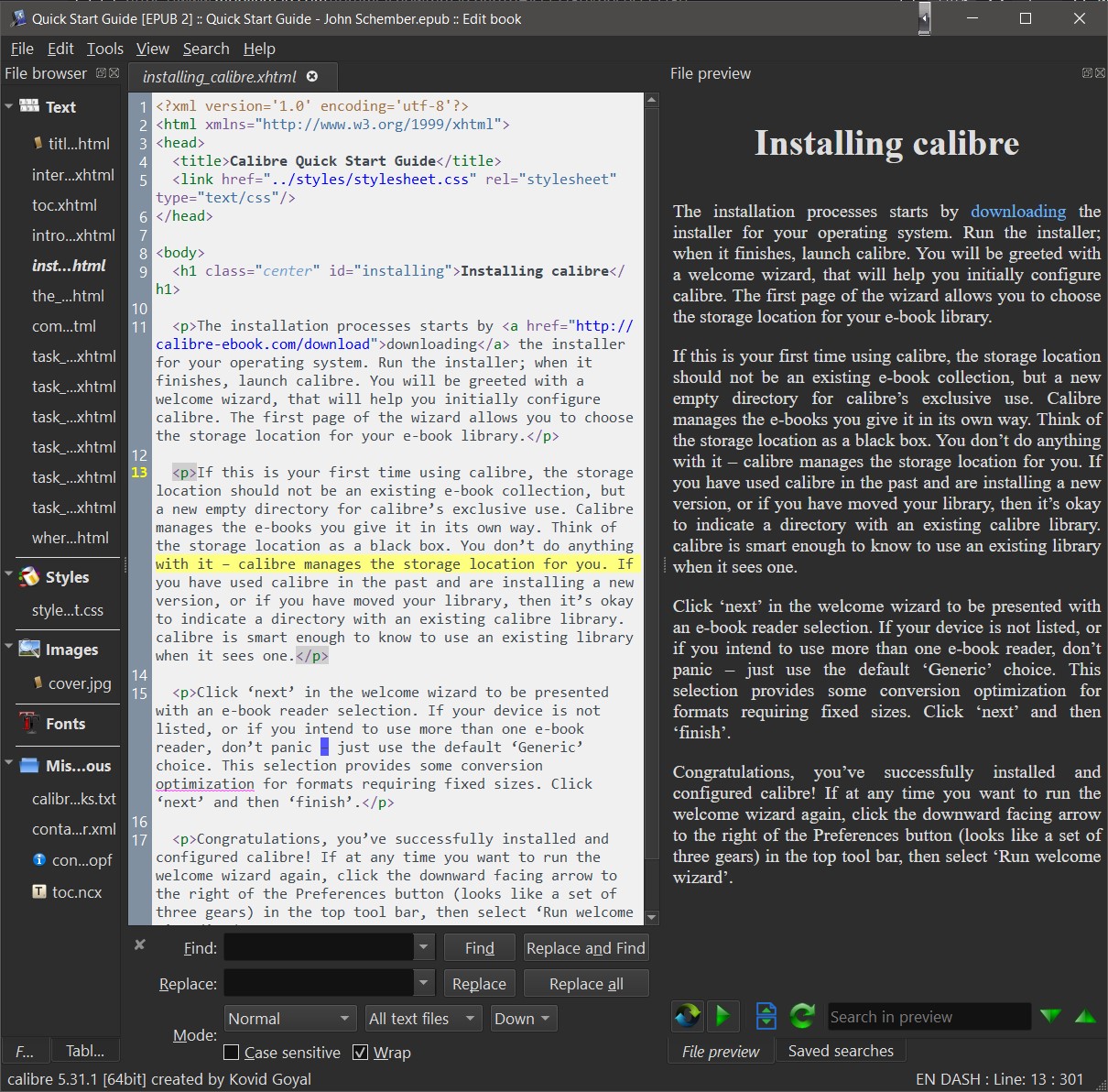

Can you post a screen shot that shows your layout, here's mine:
I have my configuration data in a non standard location via the CALIBRE_CONFIG_DIRECTORY Environment Variable

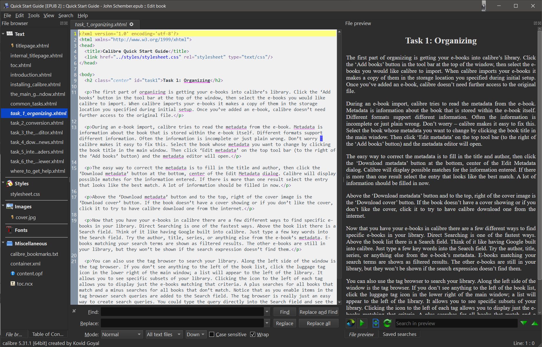

@Kovid - the OP has somehow made the File Browser and Preview panels impossibly skinny.
@thiagi.eec - can you do that, 'cos I can't, this is as skinny as I can make the three panels.
Name:	Screenshot 2021-11-13 203313.jpg

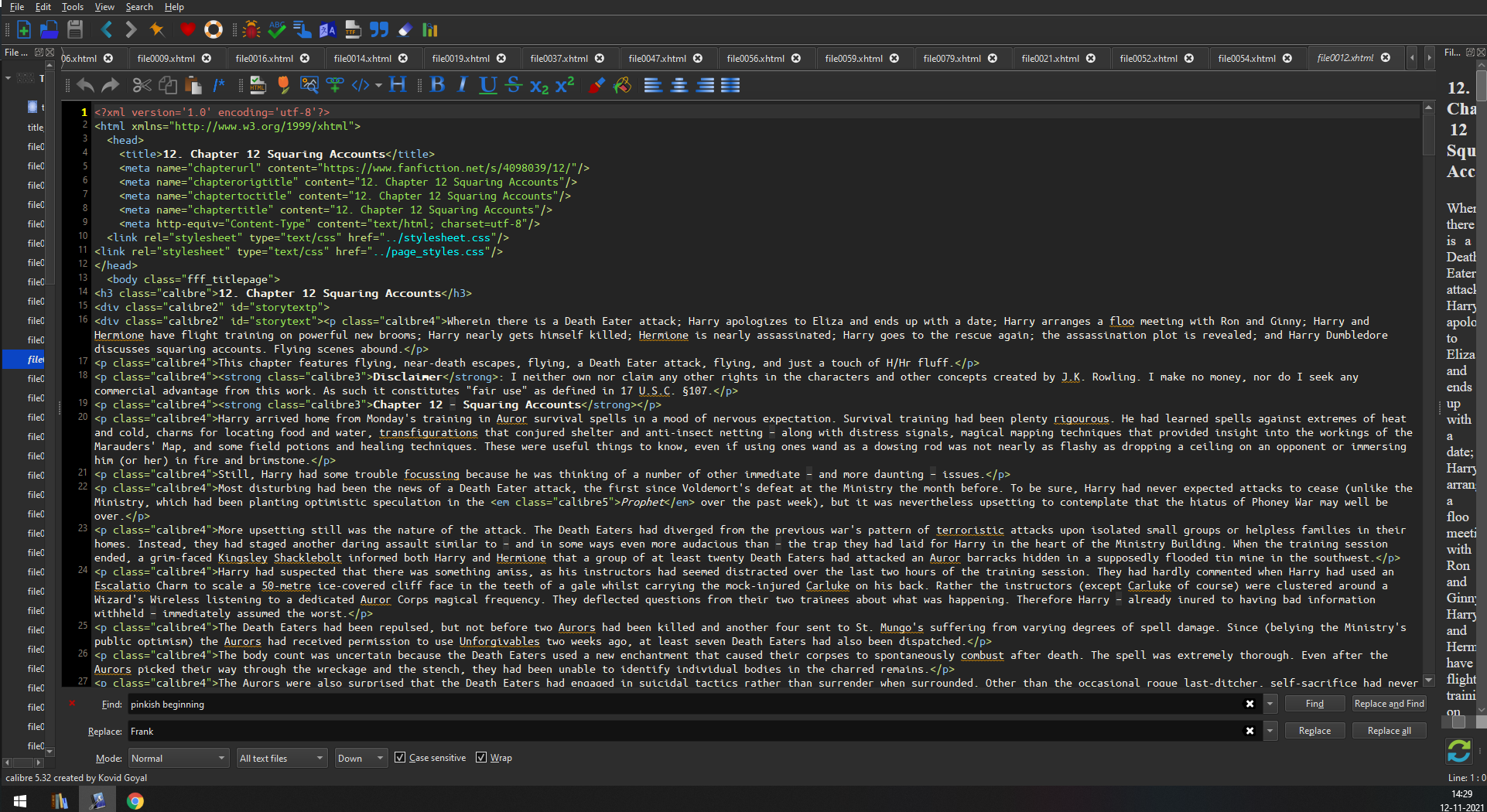

On Windows 10 Pro x64 this is what I get:
1) With the Editor open, press CTRL+F to open Find and Replace. The layout looks like this:
Name:	2021-11-13 (Before).png
2) Close the Editor just like on the image above.
3) Open the Editor, and now it looks like this:
Name:	2021-11-13 (After).png
This happens every time.
