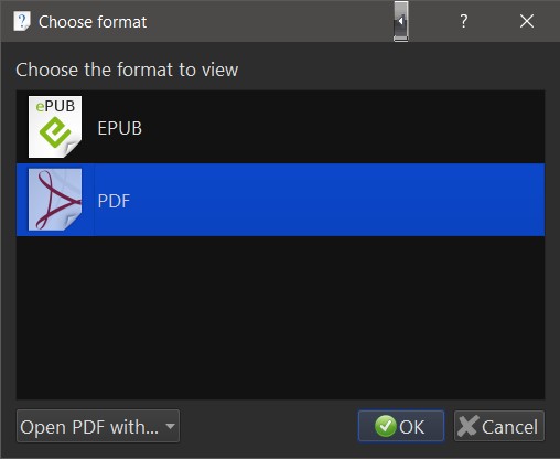

What do you mean by 'select the PDF', select it where, do you mean like this:
Name:	Screenshot 2021-12-04 111827.jpg
If you have unchecked PDF in the "Use calibre viewer for": list, that should open the program that is configured as the OS default handler for PDFs - e.g. Acrobat, PDF xChange, whatever.
