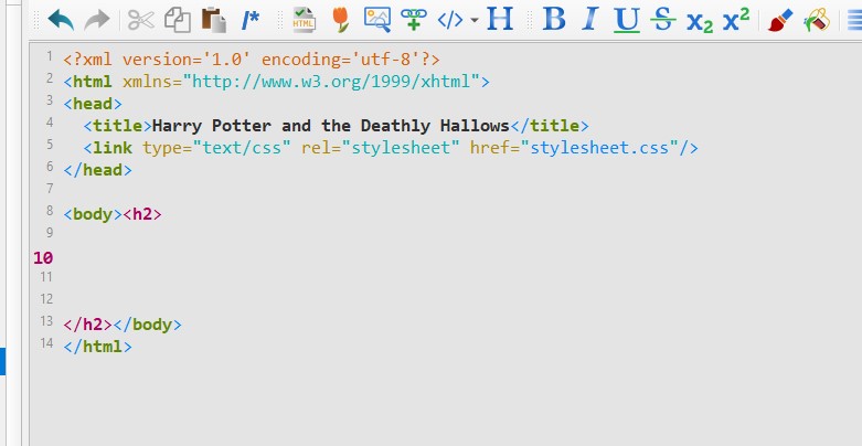

I have also noticed the issue the OP mentioned and I quickly got out of the habit of using the ctrl- functions for headings.
Have a look at the image. In this example it is a blank page ready to move text into it. My first step is to create a level <h2> heading.
If I simply place my cursor on an empty line (line 10) to add the tags, then press ctrl-2 I end up with the tags spread as shown in the image...

The tool is meant to change an existing paragraph to a heading. If you put the cursor outside of any paragraph, the results are undefined. I could possibly make it a bit more intelligent when the cursor is adjacent to a paragraph but not inside one to use the adjacent paragraph, that might help your use case a bit.
Oh right. I thought it was meant to work like the "Insert Tag" option. But, yes I see what happens when using it on an existing paragraph.
My workflow is not like that. I wouldn't first create a paragraph <p></p> then use ctrl-2 to change it.
Thank you.
