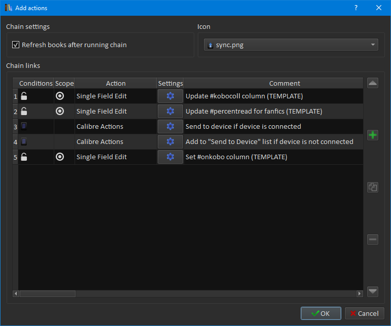

So I have an action chain to either send directly to device (if connected) or add to the send-to-device reading list (if not connected) and then set the #onkobo boolean - y is on device, n is on device but not up-to-date (fanfics with new chapters), undefined is not on device.
Name:	2021-08-14 01_31_02-Add actions.png

Here it is.
It likely won't work out of the box - the first two actions, in particular, are templates that rely heavily on custom columns. Either fix those or delete them - you'd want to look at "update #kobocoll" anyways because I highly doubt we use the same Kobo shelves. It should be easy enough to follow but if you need help pop over to this thread.

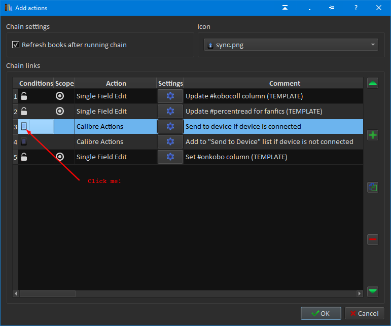

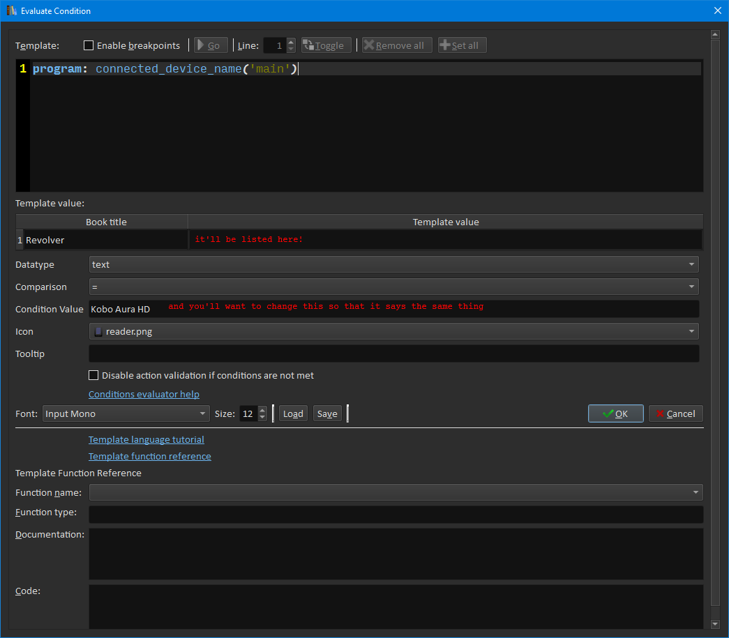

For step #3 ("send to device if device is connected"), unless you're using an Aura HD like me you'll want to change the condition to use your actual device name. So plug in your device and do this:
Name:	2021-08-15 20_36_33-Add actions.png
Name:	2021-08-15 20_34_35-Evaluate Condition.png

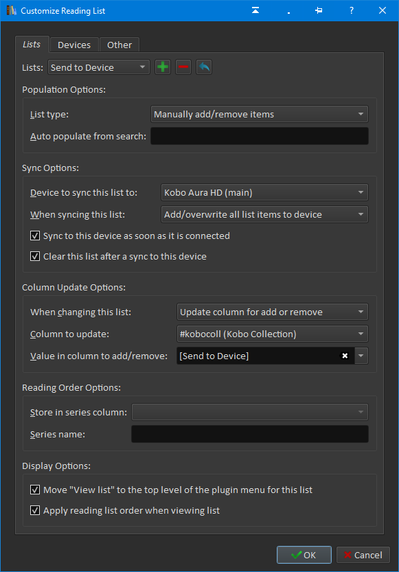

Step #4 might be invalid if you don't call your reading list exactly "Send to Device." So just fix it. If you haven't already got that reading list, here's my settings:
Name:	2021-08-15 20_43_52-Customize Reading List.png
