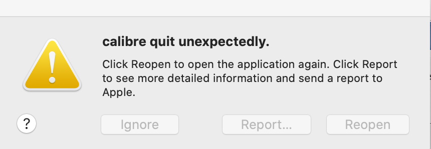

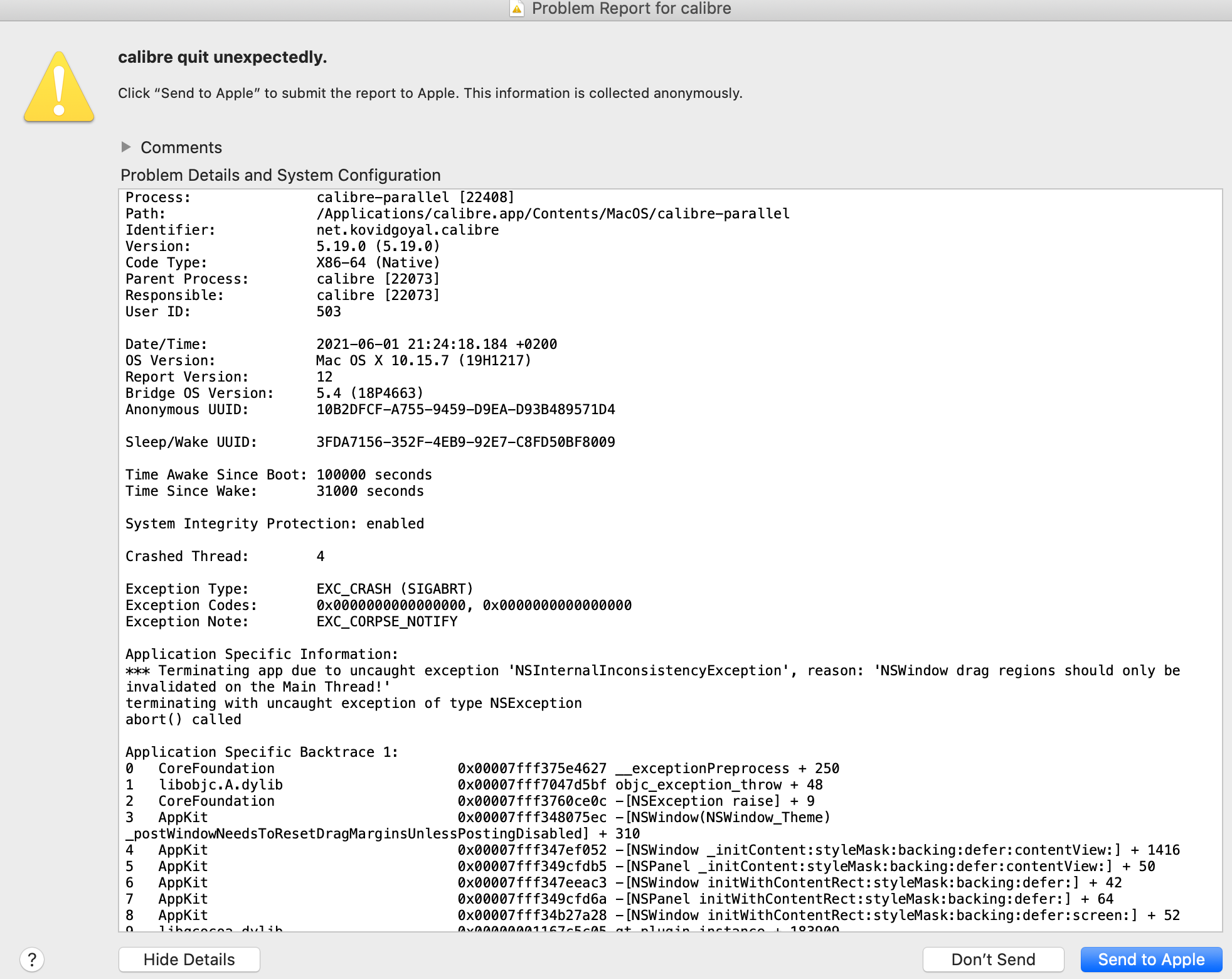

I am using the latest version, 5.19 but I this also happened at 5.18 (I therefore waited for 5.19).
When I select multiple books for Metadownload, it gives an error It can't find any metadata and then I get a crash message too, to be send to Apple.
But when I select an individual book (out of that) it can find metadata and processes it. Even when multiple books selected which metadata can be found, it works.
So somehow when you select multiple books and when 1 book has no metadata to be found it crashes the app.
I used to app for years without any issues like this.

I already saw the thread to delete the cache json file from Miscellenaous, so I tried that one too.
See also screenshots of the Apple message.
Any thoughts?

"Failed to communicate with worker process" oftens means that security software is killing the child process. If you have any running, disable it temporarily and see if it works.

That's almost certainly some security process killing the worker process calibre uses assuming its a vurus because it is contacting multiple websites.

The only security I have is the MacOS Firewall, Lulu Firewall and a raspberry pi with pihole as an ad blocker. Even with all these three turned off I get the error.
It only happens with books where it seems that there is no metadata available, other books where it can find metadata work fine.
I will wipe/reinstall calibre I think to see if that helps.

I reinstalled the app (removed it first using AppCleaner).
It works straight out of the box, no re-authorizations for firewalls etc needed.
Lost my plugins of course and had to set my kindle email address again, but that is fine.
