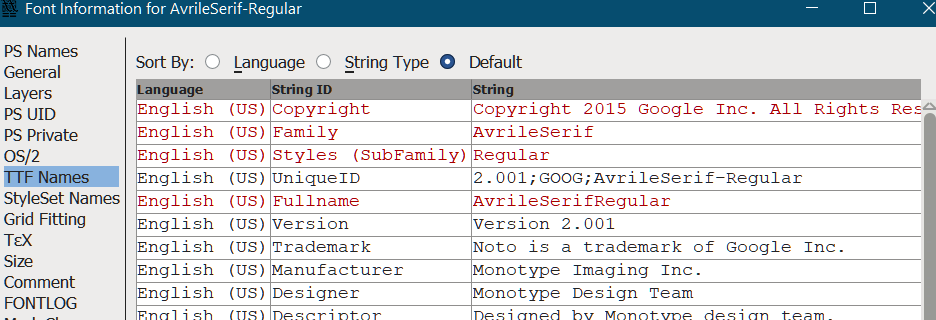

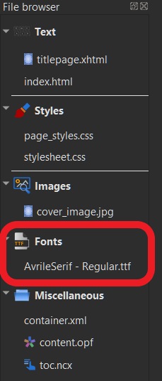

Here are screen shots showing the spaces removed from the font's name in FontForge, and yet added back in by Calibre (or Word) after embedding in the Word document and using Calibre to convert the DOCX -> EPUB.
Note in the FontForge page, the I've reduced the TTF name from "Avrile Serif - Regular" to "AvrileSerifRegular", but in Calibre, following the corversion, it shows as "AvrileSerif - Regular.ttf" So it keeps the space removal in the Family name, but adds spaces to separate the Style name.

I change the name under PS Names and TTF names and it seems to work for me. I think the family name under PS Names is the one that is displayed by most tools.
I think that's the same thing I did. Could you post a screen shot of what you think you're doing differently? Maybe I'm missing something obvious.

DNSB, you're right - you do need to make that change on the PS Names tab, even for the TT version of the font. But as you can see in the screen shots I attached above, that doesn't matter: even when it's all set correctly there with no spaces for for Fontname, Family Name, or Name For Humans, Calibre still adds in the spaces.
Specifically, what Calibre is doing is putting the Family Name, then a space, then a hyphen, then another space, then the Style (SubFamily). If Calibre were to use the Fullname instead (that's what you can set as "Name For Humans" on the PS Names tab), we could control it via the font editors (exactly as you've described), but Calibre doesn't do this.
