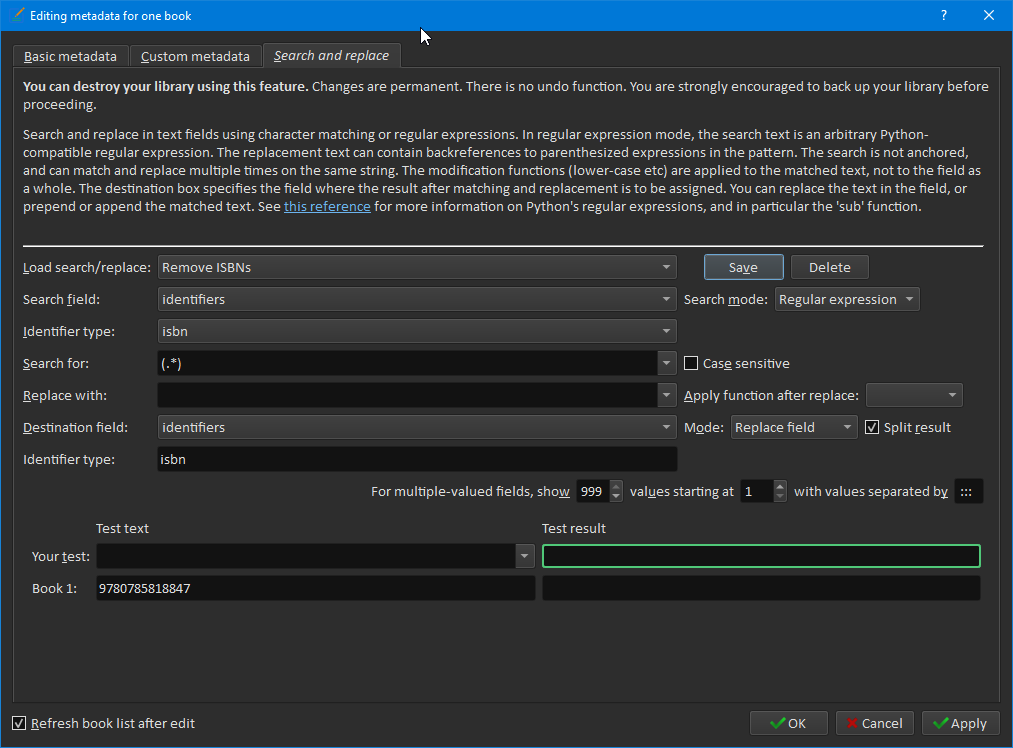

My DB "ISBN" file is corrupted and I would like to delete this data and then run the Extract ISBN Plugin to refresh the data. How do I delete the existing ISBN Data ? and should I? Am I correct saying that the "Identifiers" field shows all the publishers of a particular book and I should delete this field data as well before running the plugin?
Unfortunately, I don't understand this part. You might want to run Library > Library Maintenance > Check library.
Here's how to do it with search & replace:
Name:	2021-04-12 23_36_33-Editing metadata for one book.png
However, in Calibre 5.15 there will be an option to delete an identifier from the tag browser. It's already available when running from source.
You don't need to. Extract ISBN will overwrite existing ISBNs unless they match.
