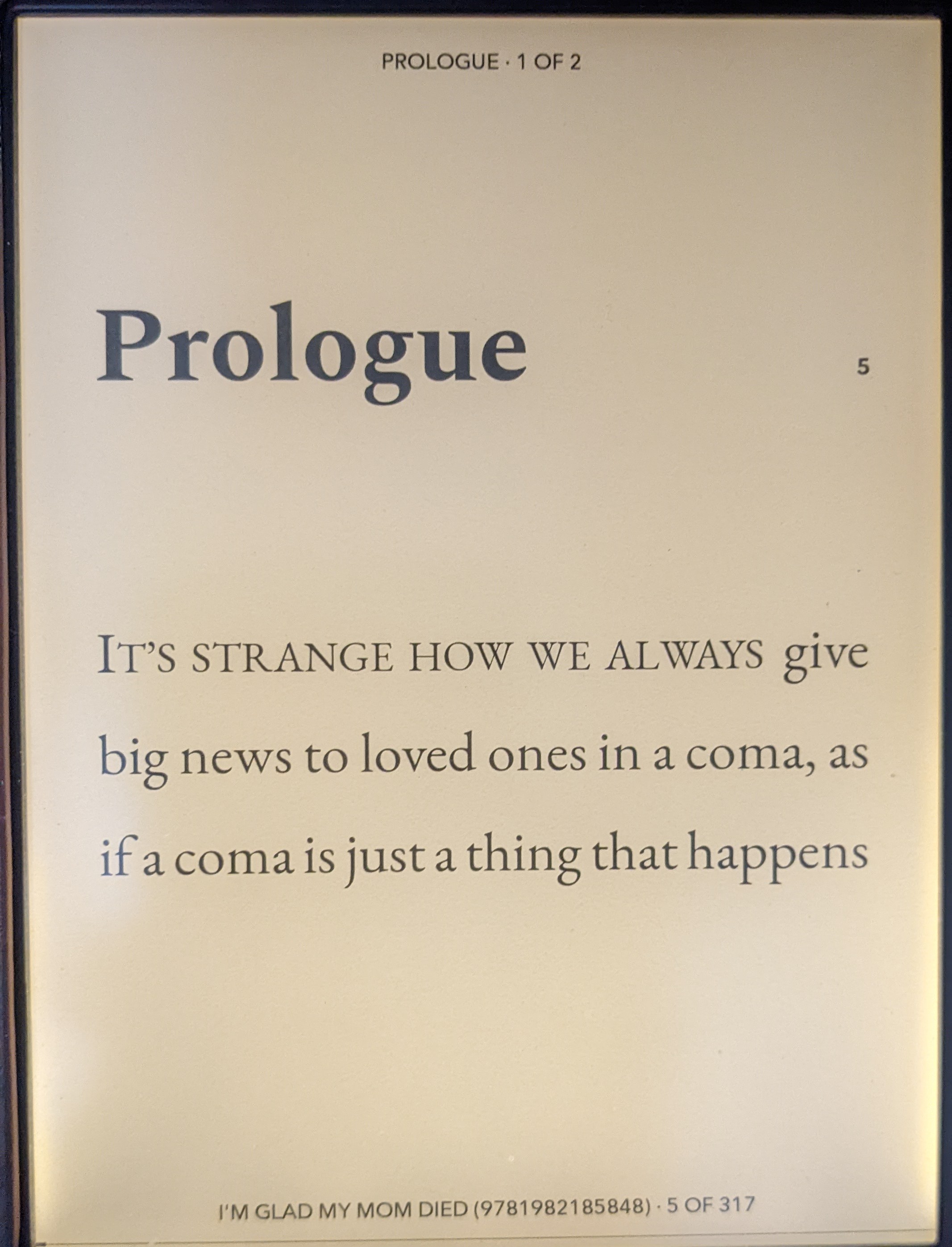

What happened to Kobo's epub support?
Recently I sideloaded a few epubs to my Clara HD and found that the formatting has completely degraded compared to previous updates.
I've attached what I mean below. The Kobo_Old image is from a Clara HD with the original firmware (4.8.11090) and the Kobo_New reflects the newest firmware update (4.33.19759). No settings were altered in either case and were taken after a factory and manual reset of the Clara HD. The same epub was also sideloaded in the examples (not through Calibre/any other manager) as well.
Is there a setting I've missed to fix the formatting for the newer firmwares?

In the old photo, you have the header off and a smaller line height. Also, you have patches applied in the old photo. So yeah, there are differences. But it's user differences. Nothing has changed with ePub in the new firmware that would make them display differently.
Thank you for responding.
I took the "old" picture just today after factory and manually resetting my device, so there shouldn't be any residual patches in effect. Even if there were, I've never added any patches to my device (I don't even know how to at the moment). The "new" photo was after doing another factory and manual reset after I took the "old" picture. I never touched the settings or added patches before either picture. The only thing I did was sideload the ebook for the pictures.

I think the question is actually about the font size and possible difference margins.
The answer is simply that it change. The scaling used in epubs changed a little bit a few firmware versions ago when there were a lot of changes in how fonts were handled. And I think there was another change somewhere after 4.8 (I don't remember exactly what or when). But, it will mean that you need to select the font size and use that going forward.
For the margins, this also changed somewhere. From memory, epubs could be set so the text was against the bezel (though each device was slightly different). There is some space now when the margin settings are at the leftmost and I have margins set to zero in the book. I have don't remember when that changed, but, it has been this way for a while.
