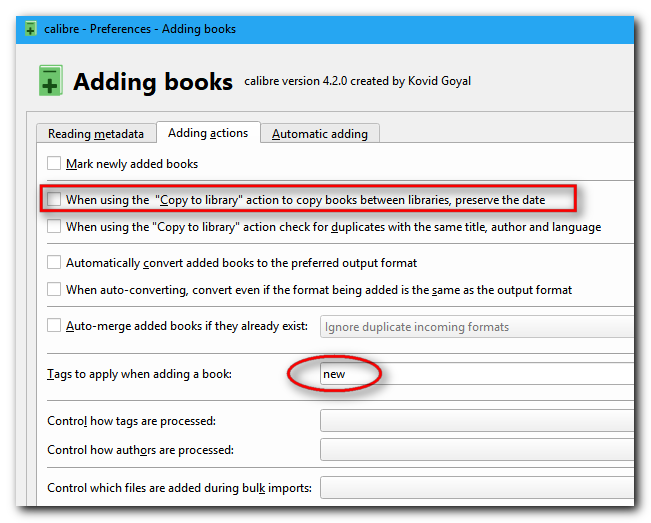

Replying to myself but just for half of the request:
For the "latest added" there are 2 ways to have a list:
Go to Preferences / Adding Books / Adding Actions /
Untick: - When using the "Copy to library" action to copy books between libraries, preserve the date
or
- Tags to apply when adding a book (add a tag like "new")... and then create a saved search or a virtual library for that tag
(see pic above)
Now... what to do to have a list of the "Latest edited"?

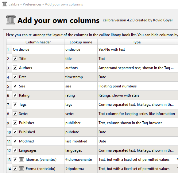

Last Modifid (all you need to do is unhide that column.
Note ANY metadata change (that affects the book) bumps this timestamp
Where can I unhide that column? In book list all columns are visible. Same as in Preferences / Add your own columns
I have a Last Action/#last_action_date custom column. I edit metadata in the book list cells, so it's easy to maintain.
Is this an automatic change? Not seeing how can i set up a custom column to achieve that!
Name:	Add your own columns.png

Solved (sorry!)... that column was too narrow in the column list for me to see it!
Now I can use this
last_modified:>=5daysago

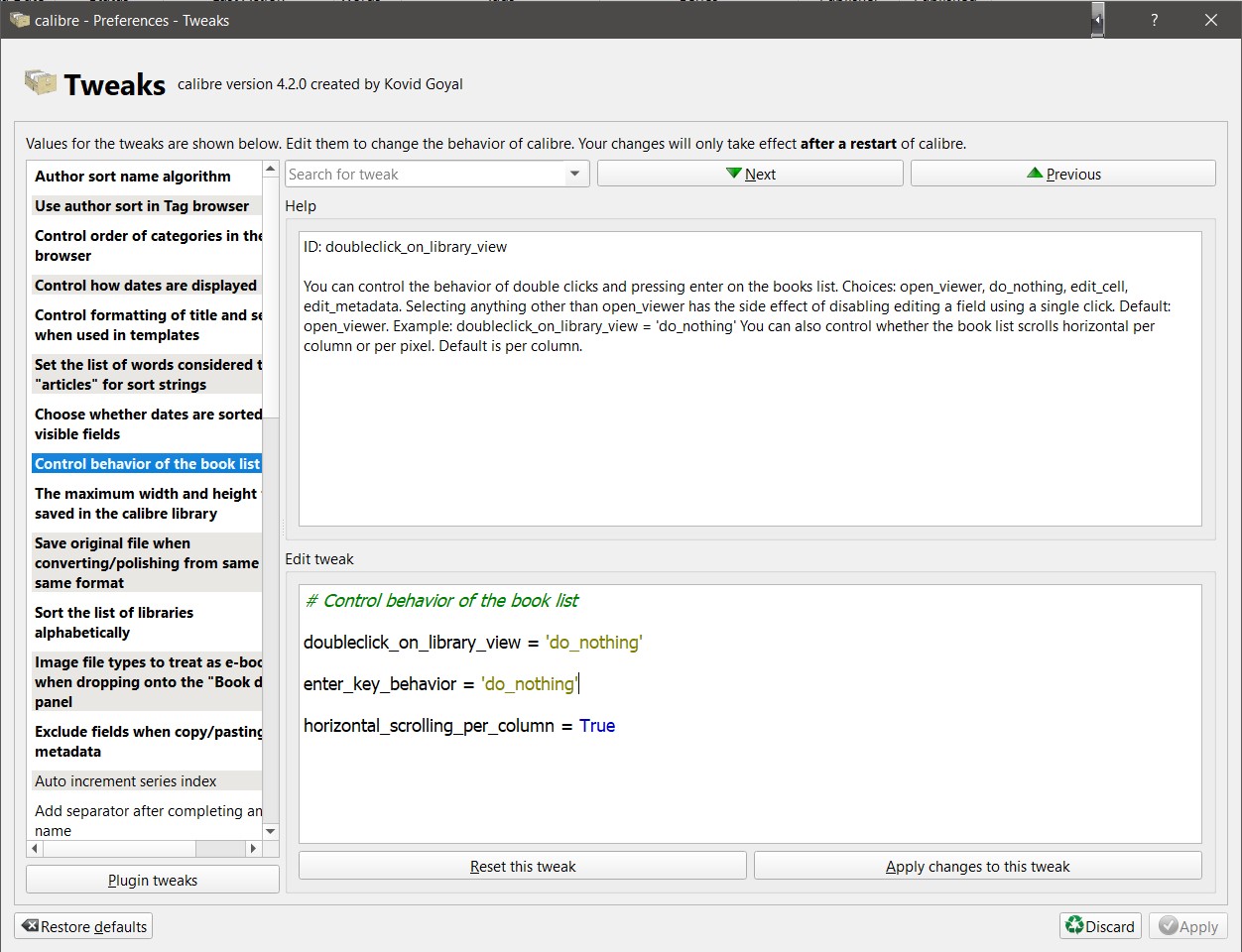

No, not automatic as such. Just a different way of editing metadata, I prefer to enter data in a single user controlled table, rather than into different fixed layout forms.
Press F2 in a book list cell, for Date cells press '=' to set to Now, press '-' to set to Undefined (blank). Press Tab to edit next cell, Shift+Tab to edit previous cell. For me, this Tweak makes it easier.
Name:	Annotation 2019-10-26 182620.jpg
