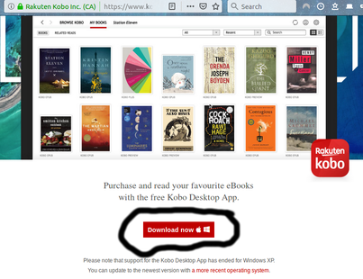

I used the webpage kobosetup.com yesterday. You go there, click the download button in order to download the kobo application for windows or mac, and then setup using the application. I did that literally yesterday, so not sure why you aren't able to get that to work. I just checked and the website opens just fine, looks identical to yesterday.

Here's where to click at kobosetup.com:
Name:	Screenshot from 2019-10-16 22-28-35.png

Well Jeez! It didn't occur to me to download the desktop app in order the set up the Kobo Glo!
I assumed that was in order to, you know, read the books on my computer!
SIGH ... okay, I will try that ...
Well, it thinks it is doing something ...
It's just spinning and the progress bar isn't progressing ...
Ah ... looks like it is finished!
WHOO HOO!
