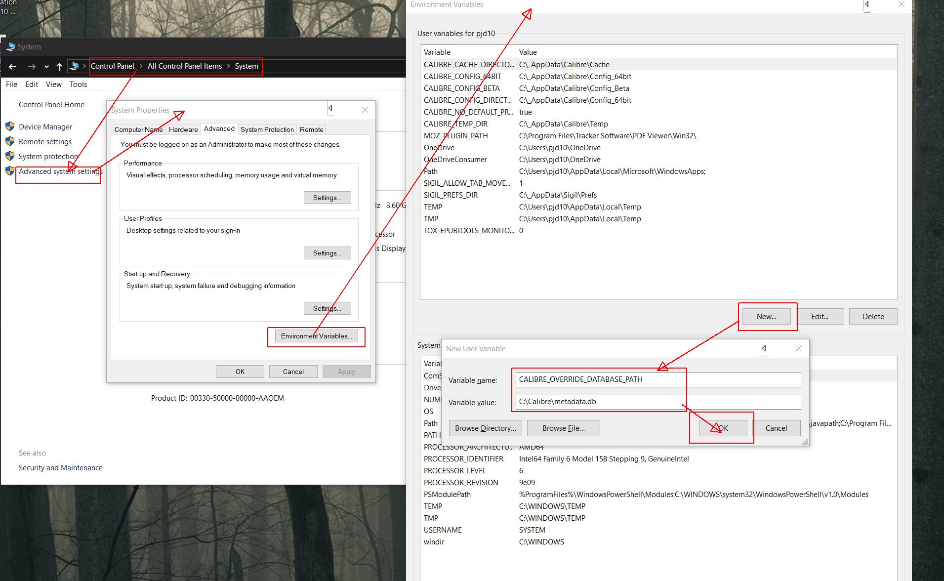

if you only have one library, move the metadata.db to the SSD and use the Environment variable

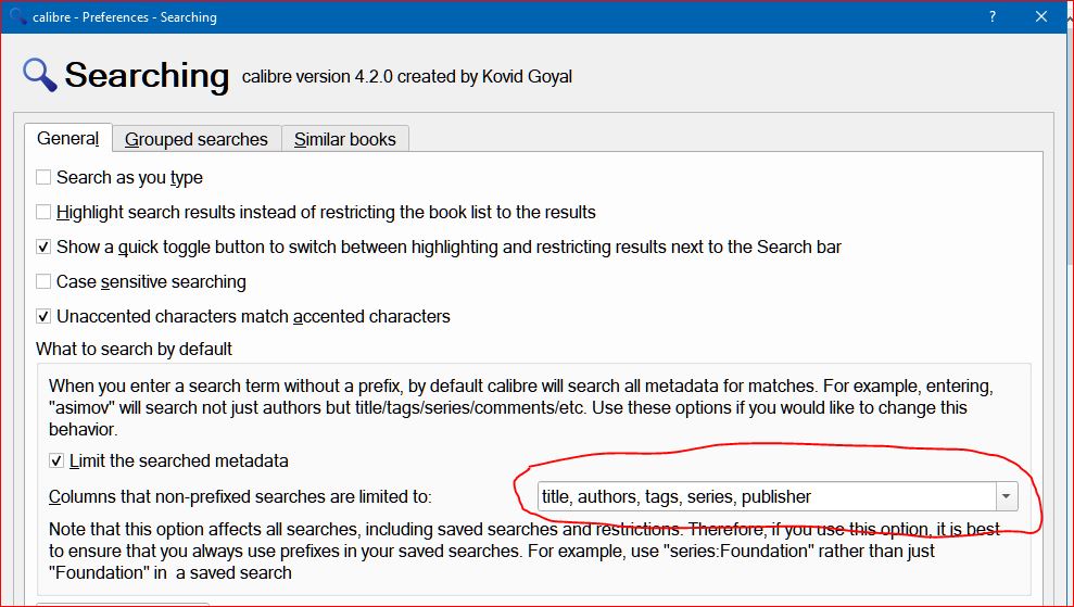

There is a setting for that so you don't have to remember to be explicit Author: name
Preferences: Searching

Originally Posted by Dorian67 View Post
I already set the preferences to author and title.
Did you also check the "Limit the searched metadata" box? The search isn't limited to what you enter in the box until you check this option.
Name:	Search Preferences.jpg
