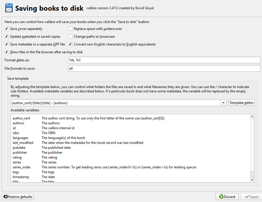

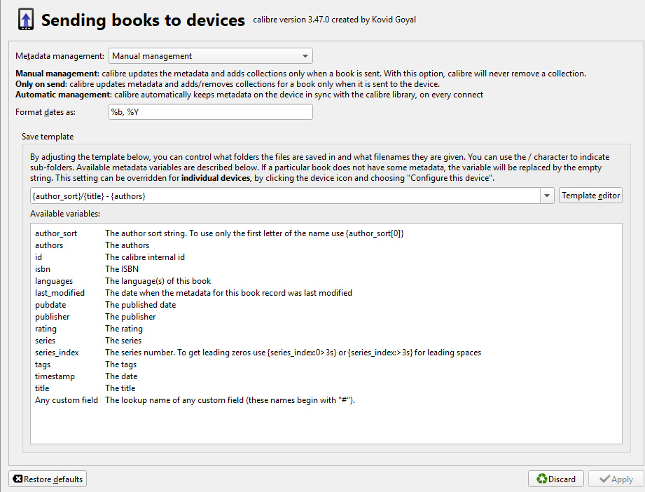

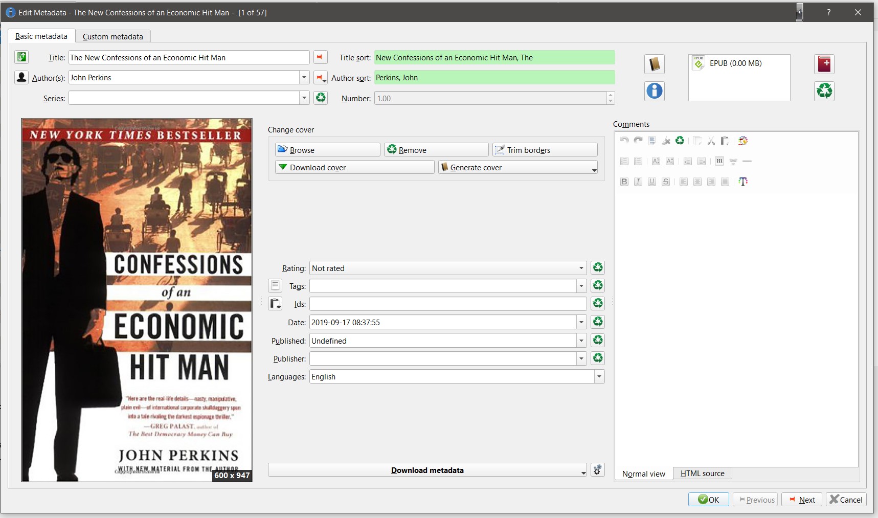

@tomx - if you can post screen shots of the Metadata edit screen to that John Perkins book and your Preferences->Send to Device and Preferences->Save to disk settings, someone will help you figure out why you have the title_sort value (articles at end) in the file name and not the raw title value.

those screens are the DEFAULTs to be used when first attaching a device.
Once the device has been attached, a COPY is stored in the preferences folder and does not get updated from a default.
IF you connect a device, right click the DEVICE VIEW Icon: configure the device. That is where yo make changes to existing device settings

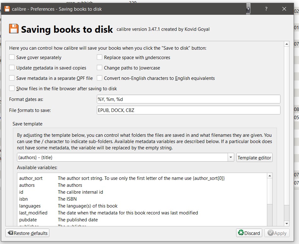

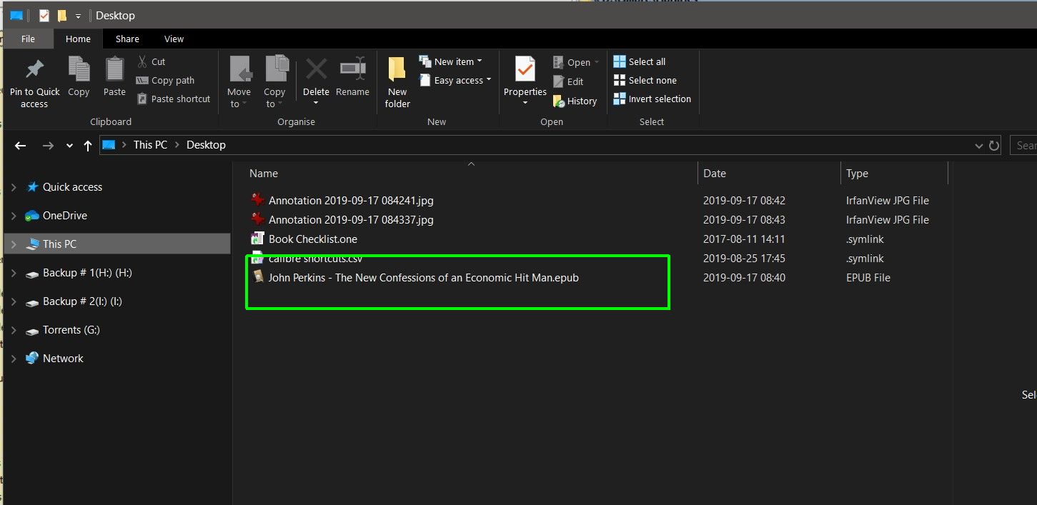

You cannot control the folder or file names within the library folder, and calibre does not provide a specific tool to copy the files with those names elsewhere - apart from pressing 'O' and copying them with your file manager.
The Save and Send templates define the file name that will be saved or sent.
Looking at your settings I cannot fathom why you would be getting {title_sort} i.e. "New . . . Hit Man The" rather than {title} - "The New . . . Hit Man" in the saved file names.
The attached screen shots show a save to disk that got the desired result.
@theducks - do the Send to Device settings control the Save to Disk behaviour - if they do then that sounds like a good reason to avoid it - which I do
