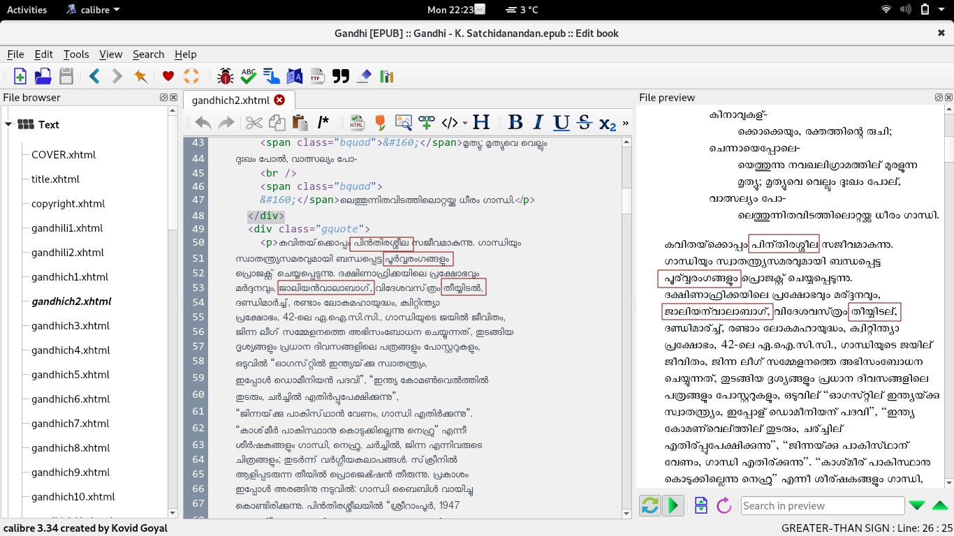

I was trying to read an epub file in my Kobo, which is in Malayalam language. The "chillu" letters (That's what those letters are called in Malayalam) were not rendering properly. Then I load the epub in Calibre and ended up in this interesting situation. Please see the attached image. I have marked the respective words in red boxes. Why the letters are rendered different in the xhtml viewer and preview panel? The rendering is perfect in the xhtml viewer, but wrong in file preview. Is there some way to rectify this? BTW, I am using Calibre (v3.29) installed form official repository in Fedora 29.
Any advice/suggestions are greatly appreciated. Thank you.

I suspect the (embedded) font has glyph issues. Try embedding another font.
Code view, is again, a different font. I think this one is from your System (and this one is usually Mono-spaced, favored by coders).

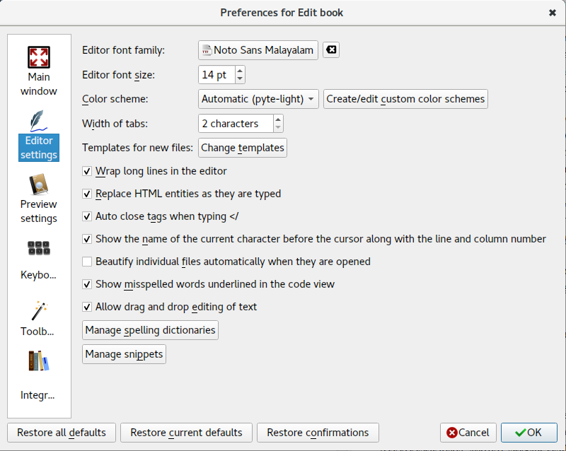

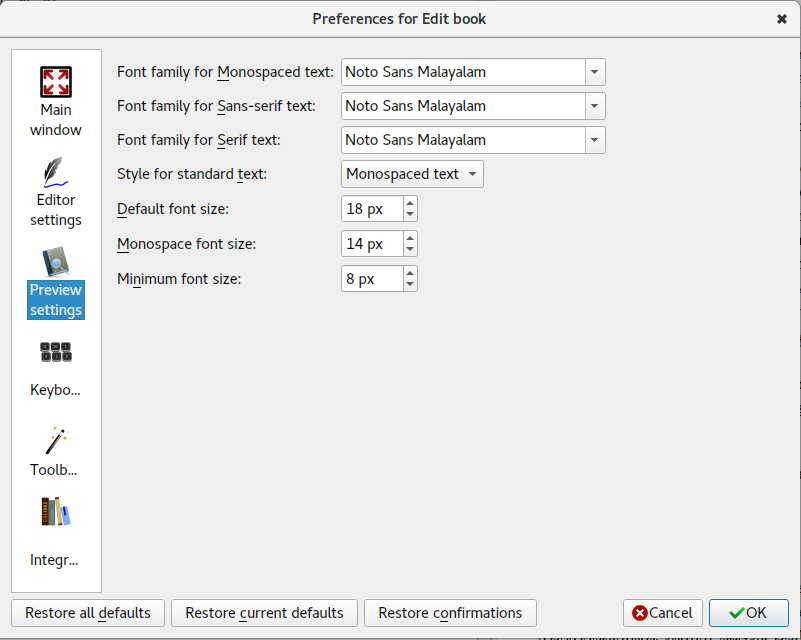

FWIW: the font for the CodeView (CV) panels are set in Edit->Preferences->Editor settings, the font for the Preview (PV) panel is set in Edit->Preferences->Editor settings. They can differ e.g. I use Consolas for CV and Liberation variants for PV
IIRC: the calibre viewer will use the embedded fonts, if they exist; and if they don't, the fonts set in the viewer's Preferences->General->Font options settings are used. Please see the attached images.
Thanks for your suggestions. I have checked both those settings and changed both to "Noto-sans-malayalam" font, which I installed from the fedora official repository. Now the fonts are seems to be same on both panels, though the same problem persists.

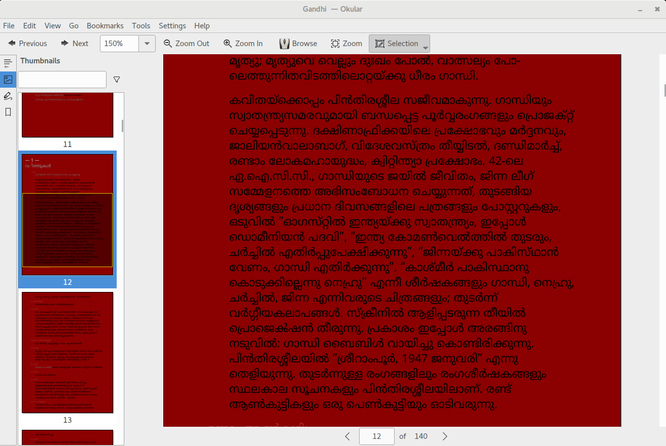

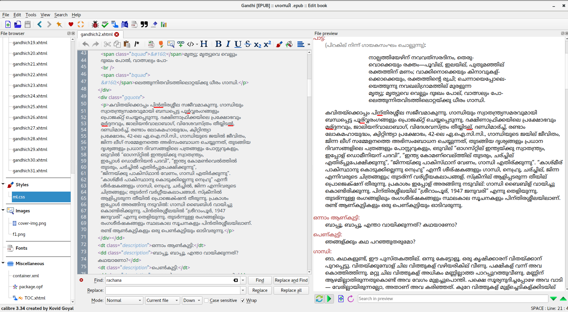

Thanks for your comments. But in this case, there is no font embedded within the epub and no information is found in the css file.
On the other hand, I am able to open and read the epub in Okular and it renders everything perfectly.
