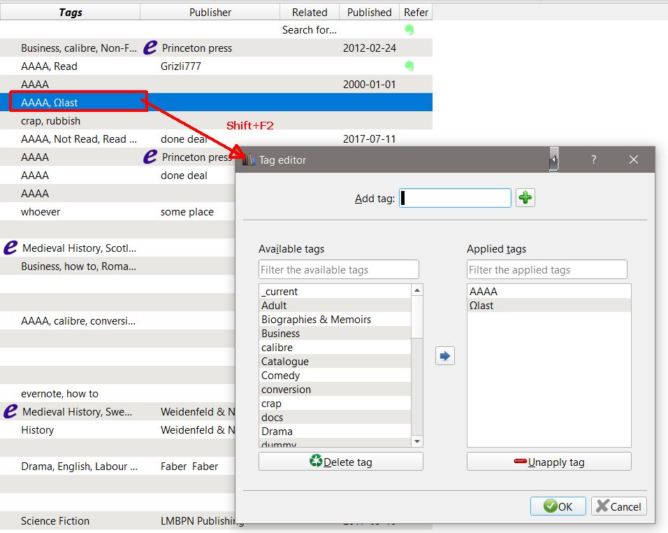

Press Shift/F2 on a books Tag cell, this will pop the Tag Editor where you can add tags and apply previously created ones, viz:

Or use the Metadata Edit Dialogue, there's a button there to do the same thing.
