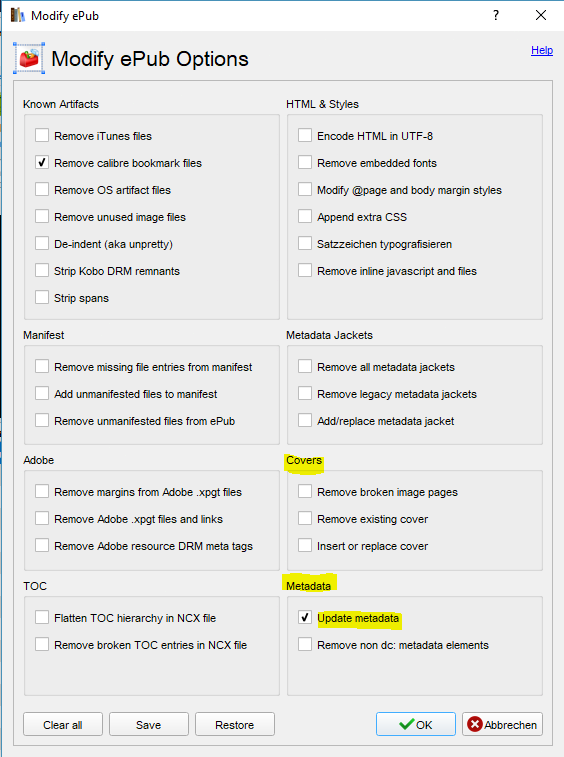

Divingduck
Posts: 1,166
Karma: 1410083
Device: Sony PRS-650
Take a look to the plugin section. There you will find the PI ModifyEPUB.
Thank o/
