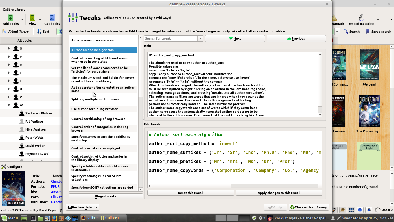

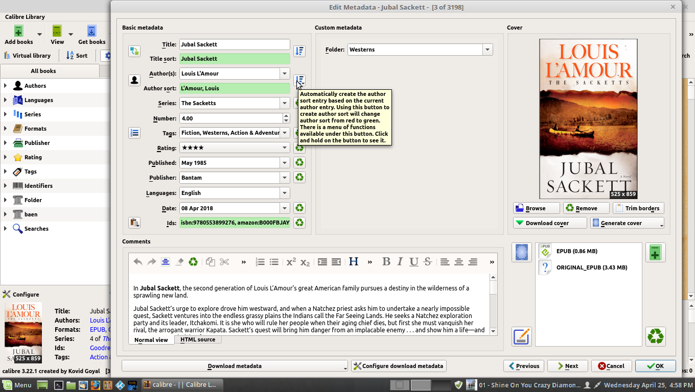

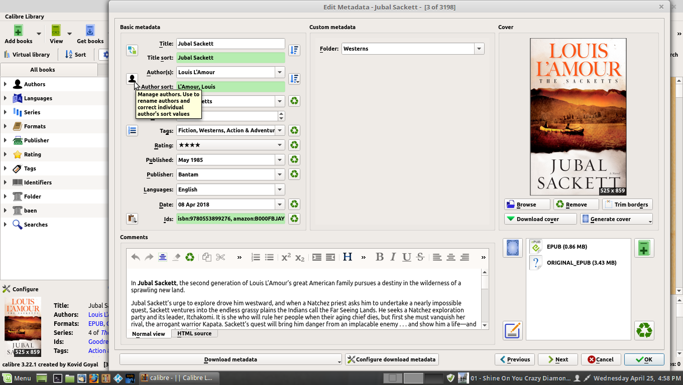

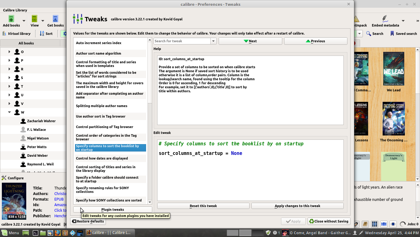

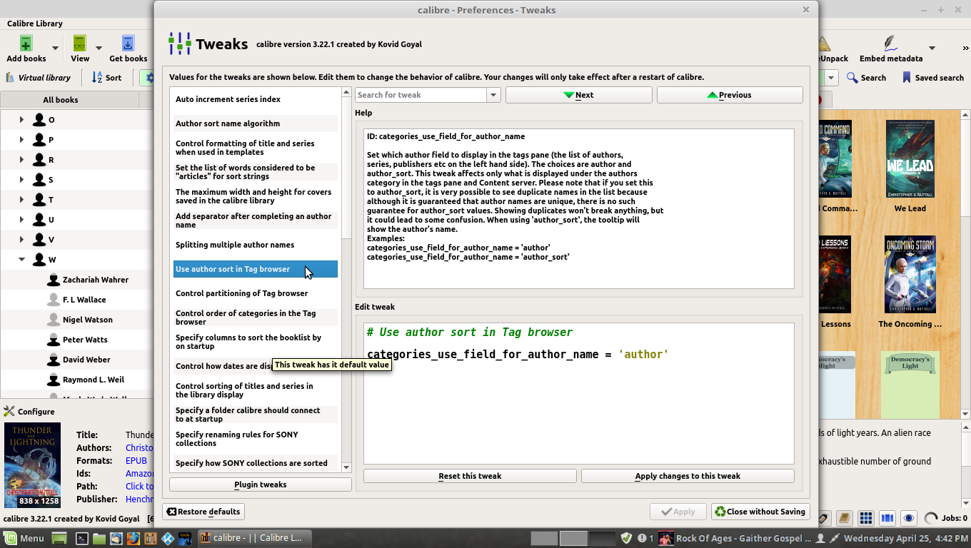

gbm
Posts: 2,219
Karma: 8888888
Originally Posted by guspasho View Post
5-6 years ago I asked how to get Calibre to import books to my Kindle and have them sort and display the author name properly, and the answer was to populate the Author Sort field, select "Use author sort for author" and reconvert *all* my books that I sideload with Calibre, and then remember to manually do the same to every book I want to add thereafter. Not only is this irritating and unintuitive, it appears that this no longer works, as I have been assiduously converting all my books in this way but when I upload them to my new Kindle Paperwhite (latest gen) they all still sort by author's first name.
NOBODY IN THEIR RIGHT MIND SORTS THIS WAY DAVID.
My books that I bought from Amazon all sort by first name. Again. Why has this solution failed? What am I supposed to do now? Is it any more convoluted? Is there another product I should be using if I want this basic functionality to work consistently?
GIGO
Fix your meta data then make sure the tweaks in calibre are set as you perfer.
